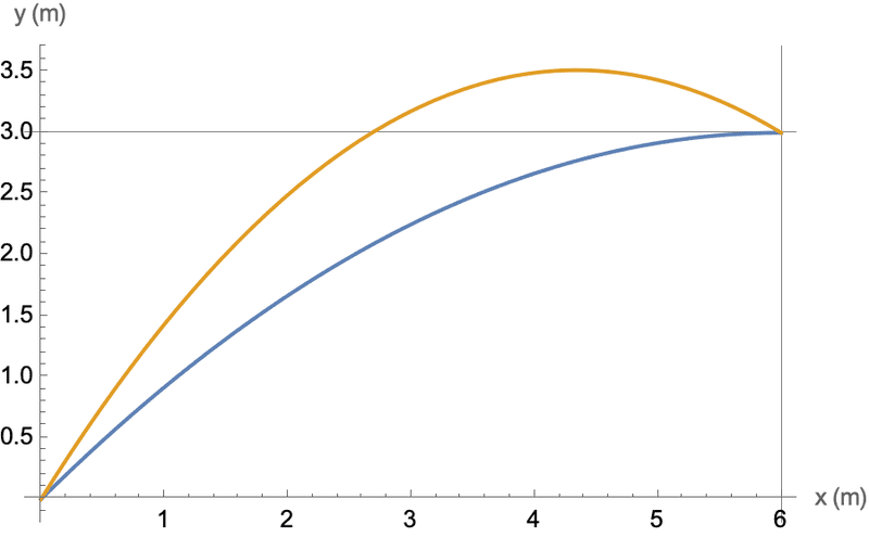

You could tell what percentage of your students is in the right frame of mind if you ask a conceptual question based on the problem. I suggest that you show them the correct trajectory (orange line) as a question.
Question: Both projectiles just barely go over the wall. The projectile in the blue trajectory is traveling parallel to the ground when it does so. Is it possible that the initial speed of the projectile in the orange trajectory is less than that of the projectile in the blue trajectory? Explain your reasoning.
It's a subtle point that needs to be understood before tackling this problem.
