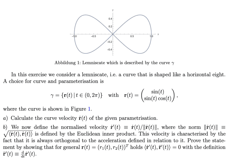

Hi,
I am having problems with task b
I then defined the velocity vector and the acceleration vector as follows
##dot{\textbf{r}}'(t) = \frac{1}{||\dot{\textbf{r}}(t)||} \left(\begin{array}{c} \dot{r_1}(t) \\ \dot{r_2}(t) \end{array}\right)##
and
##ddot{\textbf{r}}'(t) = \frac{1}{||\dot{\textbf{r}}(t)||} \frac{d}{dt}\left(\begin{array}{c} \dot{r_1}(t) \\ \dot{r_2}(t) \end{array}\right)##
Then I calculated the following:
##bigl\langle \dot{\textbf{r}}'(t) ,\ddot{\textbf{r}}'(t) \bigr\rangle=\dot{\textbf{r}}'(t) = \frac{1}{||\dot{\textbf{r}}(t)||^2} \left(\begin{array}{c} \dot{r_1}(t) \\ \dot{r_2}(t) \end{array}\right) \cdot \frac{d}{dt}\left(\begin{array}{c} \dot{r_1}(t) \\ \dot{r_2}(t) \end{array}\right)= \frac{1}{||\dot{\textbf{r}}(t)||^2} \Bigl( \dot{r_1}(t) \frac{d}{dt} \dot{r_1}(t) + \dot{r_2}(t) \frac{d}{dt} \dot{r_2}(t) \Bigr)=\frac{1}{||\dot{\textbf{r}}(t)||^2} \Bigl( \dot{r_1}(t) \ddot{r_1}(t) + \dot{r_2}(t) \ddot{r_2}(t) \Bigr)##
Unfortunately, I can't get any further. The following must apply ##\bigl\langle \dot{\textbf{r}}'(t) ,\ddot{\textbf{r}}'(t) \bigr\rangle=0## so that this is the case, the expression ##\dot{r_1}(t) \ddot{r_1}(t) + \dot{r_2}(t) \ddot{r_2}(t)=0##, but why is this the case?
My derivation is probably already wrong, but I don't know how else to solve the problem.

Lambda96 said:
ddotr′(t)=1||r˙(t)||ddt(r1˙(t)r2˙(t))
no. The normalized acceleration vector should be the derivative of the normalized velocity vector.

To add a hint to that, what you are looking for is a property of any vector of constant magnitude. Don’t get bogged down in the particular expression in terms of a normalized vector.

Thank you Hill and Orodruin for your help 👍👍
I have now proceeded as follows
##\bigl\langle \dot{r}', \dot{r}' \bigr\rangle=\dot{r}' \cdot \dot{r}' =1##
Now I have simply formed the derivative ##\frac{d}{dt}##
##\ddot{r}' \cdot \dot{r}' + \dot{r}' \cdot \ddot{r}' =0##
##2 \dot{r}' \cdot \ddot{r}' =0##
##\dot{r}' \cdot \ddot{r}' =0##

Indeed.
