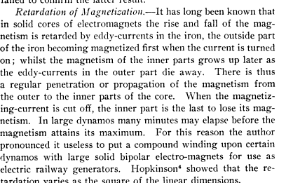

Two effects in play here
first, reluctance of even a short air gap is more than a long piece of iron.
Relative permeability gives that ratio...
second, eddy currents make the iron appear less permeable for AC than for DC
From Sylvanus P Thompson's "Dynamo Electric Machinery", 1901
g=PA16&img=1&zoom=3&hl=en&sig=ACfU3U2-7v3al1dYerqofu7npsCNskW_aA&ci=184%2C765%2C709%2C454&edge=0.png
and that's why laminations are so necessary in the core.
I measured relative permeability of around 20 on some unlaminated stainless steel that should have been in the hundreds.
You'll see in some magnetic steel spec sheets permeability at 60hz as well as DC.

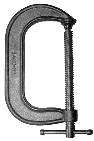

You might try for a core a hardware store C-clamp where you could introduce a known and reproducible air gap by clamping down on a nonmagnetic shim ...
