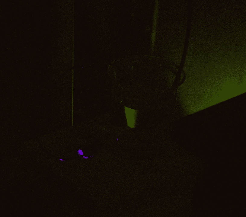

Hi,
I am doing high voltage testing (20-35 kV or more) where I am trying to capture corona discharge. My DUT is in a dark test room with no light. I am using a Canon EOS T7 (2000D) DSLR to capture the corona. What I would like to know is the wavelength of the corona so I can do further investigations. The light it not too bright as you can tell form the picture attached.
Please note: In the picture attached, the green light is coming from a small LED that was on a different measurement device in the room. The LED has since been covered, so the green light is no longer present. I included this image because the green light may makes it a little clearer the size scale of things. This image is of a 10 AWG wire connected to a 16 AWG wire using a ring terminal. The connection is in a beaker filled with transformer oil to eliminate discharges at that point. The other end of the 16 AWG wire has a small plastic connector attached and is in air. The corona is occurring where the wires are inserted in the connector. The purplish color on the beaker is not corona from the connector inside but a reflection from air. All of this is sitting on a shiny white insulator which is also the reason for the small reflection at the bottom of the wire.
Any suggestions on how to measure the wavelength of this light while not actually in the room is much appreciated. I can run cables to any equipment inside the room but objects in the room must be fixed in place.

I expect it will be broadband UV excitation, but if you analyse the spectrum you will see the spectrum of ionised atmospheric gasses, and maybe the metal of the wire.
https://en.wikipedia.org/wiki/Aurora#Colors_and_wavelengths_of_auroral_light
You will need a telescope and a grating to generate the optical spectrum.
The wide UV spectrum will be more difficult to analyse due to transmission of UV.
Good idea. I'll see if I can find a grading for a camera lenses specifically. If not, I'm sure I can find a way to attach one. I think the tricky part would be calculating the wavelength though. I would need the distance to the sensor I'm guessing? With such a short distance, I think too rough of an estimate might really skew the calculations.
You can calibrate a spectrograph with different chemical composition LEDs that produce known colours.

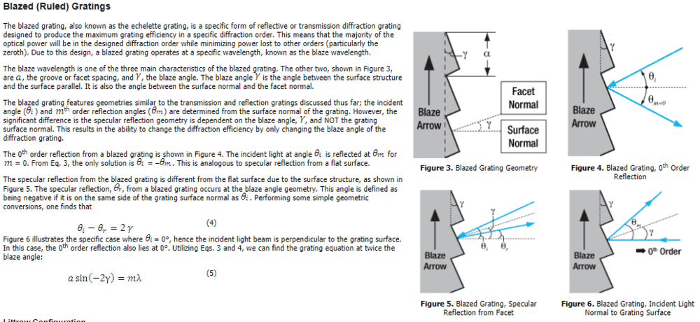

Ok I think I understand about the groove angle. Is Case a or Case b the correct angle it's measuring?
Ok actually I think both of those are wrong. I reviewed the grating tutorial on Thorlab's website earlier. They have blaze and transmission listed separate so I thought this angle was not the angle discussed for braze. I just downloaded the PDF drawing of this and it specifically lists it as braze angle. So I understand that now and see both of my previous drawings were incorrect.
I believe this image gamma is the angle it's referring to, right?
