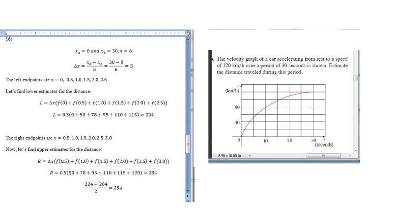

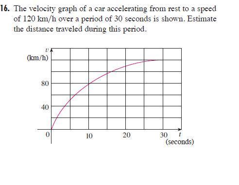

I have completed a problem and would like you to check it and see if I got it right.
The velocity graph of a car accelerating from rest to a speed of 120 km/h over a period of 30 seconds is shown. Estimate the distance traveled during this period
Here is the graph, where a=40 http://www.webassign.net/scalcet/5-1-016alt.gif
You will see a print screen of my work. Did I do correctly that I put together a lower and upper estimates and divided the sum by 2 in order to estimate the distance traveled? I believe I made a mistake.
  • Handwritten working on a typed-looking page: x_a = 0, x_b = 30, n = 6, delta x = 5, lower and upper Riemann sum estimates with values 224 and 284, averaged to 254, beside a velocity-time graph of a car in km/h against seconds.
Your endpoints are all wrong. You have 0, .5, 1.0, 1.5, 2.0, 2.5, 3.0. In the graph they are 0, 5, 10, 15, 20, 25, 30 seconds. In both estimates you should have [itex]\Delta t[/itex], not [itex]\Delta x[/itex]. x should not appear in your work.
Since the velocities are in km/hr, your time units should be in hours, not seconds. 5 seconds = 5 sec X 1 min/60 sec X 1 hr/60 min = 1/720 hr. This is your [itex]\Delta t[/itex]. The distance will be in km.

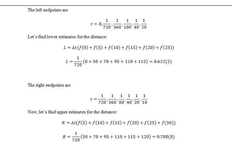

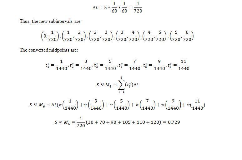

Here is my revised version. Please can you check this one?
I have two solutions: the first one is for midpoints.
The second one is for lower and upper estimates.

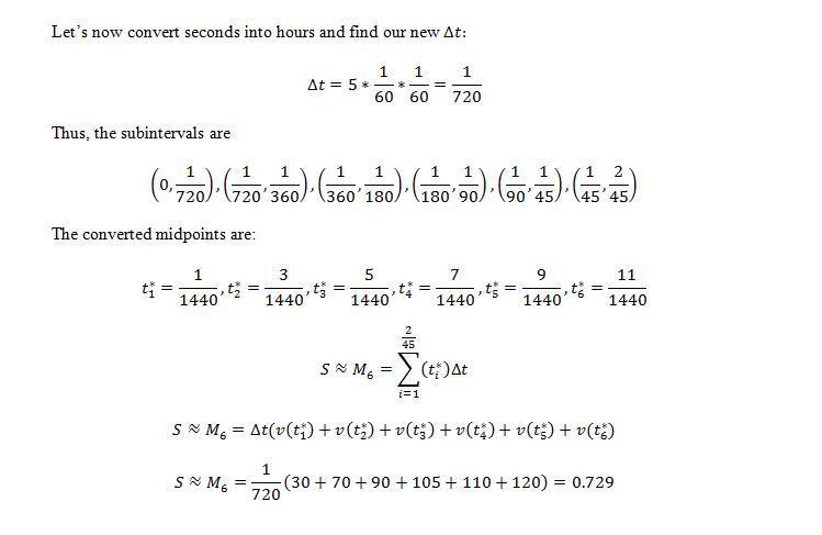

  • Handwritten-style typed working converting seconds to hours: delta t = 5 * 1/60 * 1/60 = 1/720, subintervals listed, converted midpoints 1/1440 through 11/1440, and midpoint sum S approx M6 = 1/720(30 + 70 + 90 + 105 + 110 + 120) = 0.729.

  • Handwritten-style typeset calculation of left and right endpoint Riemann sums: left endpoints t = 0, 1/720, 1/360, 1/180, 1/40, 1/20 giving L = 0.622(2), and right endpoints t = 1/720, 1/360, 1/80, 1/40, 1/20, 1/10 giving R = 0.788(8).

You still have quite a few mistakes. In the 2nd image, your summation should go from i = 1 to i = 6, not 2/45. In the second and third images, there are numerous errors in the converted times. From the graph, the times are 0, 5, 10, 15, 20, 25, and 30 seconds.
5 sec = 1/720 hr
10 sec = 2/720 hr
15 sec = 3/720 hr
30 sec = 6/720 hr
Several of your reduced fractions are wrong. For example, 6/720 [itex]\neq[/itex] 1/10 hr.

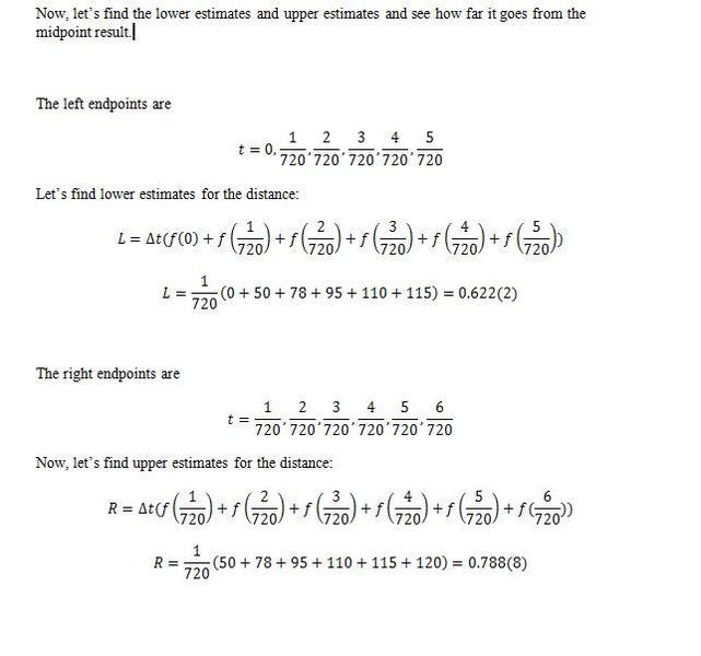

OK, based on your suggestions, I have completed the assignment. I hope that this time I did it correctly. Please take a look.

  • Typed working estimating a distance integral with Riemann sums: left endpoints t = 0, 1/720 to 5/720 with L = (1/720)(0 + 50 + 78 + 95 + 110 + 115) = 0.622(2); right endpoints to 6/720 with R = (1/720)(50 + 78 + 95 + 110 + 115 + 120) = 0.788(8).
