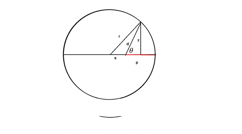

I am interested to find the length shown in red in the attached figure. I want this length as a function of d (shown in blue) and the angle θ. Then I will integrate this length to dθ from 0 to π/2.
Firstly, I used the law of the triangle to determine the length s which when subtracted from the radius r yields the desired length p.
s2+2sd cosθ+ d2-r2=0
Then I used a substitute a2=d2/ r2-d2
which gives, -sqrt(r2-d2 ∫ sqrt {(a2 cos2(θ)-1} dθ

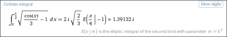

Lastly, I used wolframe alfa to calculate the part under integration, here is what I got.( I used r=1 and d=1/2 r).
The result is a complex number ( attached). I don`t understand how the integration of a length which is a real number results into a complex number.

"law of the triangle" to determine the length s which when subtracted from the radius r yields the desired length p.
Could you explain this ? To me it looks as if ##(s+d\cos\theta)^2 < r^2 ## !
Consider the triangle with sides r, d and s,
r2= d2 + s2 + 2 ds cosθ
This is a quadratic equation of s, given d and r.
Funny, I would say that ##
(s+d\cos\theta)^2 + z^2 = r^2##

About the question: you want to vary ##\theta## from ##0## to ## \pi/2##. Is s a constant ? then doesn't d stay constant too ?
Yes ##\theta## varies from ##0## to ##\pi/2##. d is a constant.
d was shown in blue. What happens when ##\theta## reaches ##{\pi\over 2} + \arcsin ({2r\over d})## ?
[edit] Sorry, ##{\pi\over 2} + \arcsin ({d\over 2r})## of course. This is when s = r and p goes through zero.
(to me that means d is approximately where z is in your drawing. meaning p = 0.
I drew another circle with more clear lines. z is always perpendicular to r.
I didn`t get you at the second sentence. d is always ≤r
OK, so I see: ##z = d\sin\theta, \quad s = \sqrt{r^2-z^2} - d\cos\theta, \quad p = r - s## ( or ##p = | r - s | ## since you want the length of p). The p = 0 occurs when ##\theta## reaches ##
{\pi\over 2} + \arcsin ({d\over 2r})##; that's when the bottom end of the blue line is on the circle as well.
Note only the + sign in your solution of the quadratic equation for s applies because s > 0. So ## s = \sqrt{r^2-d^2\sin^2\theta} - d\cos\theta ##
In your word document you want to integrate $$
\int_0^{\pi/2} r + d\cos\theta - \sqrt{d^2\cos^2\theta + r^2 - d^2 } \ d\theta$$ but you evaluate $$
\int_0^{\pi/2} - \sqrt{d^2\cos^2\theta - r^2 + d^2 } \ d\theta$$could that be the problem ?
By the way, ##d^2\cos^2\theta + r^2 - d^2 = r^2 - d^2\sin^2\theta## ; as long as ##d \le r## taking the square root should be OK.

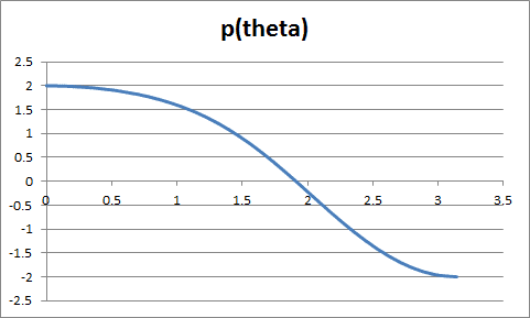

For example, $$ \int_0^{\pi/2} r + d\cos\theta - \sqrt{d^2\cos^2\theta + r^2 - d^2 } \ d\theta = {\pi/2} r + d - f(d, r)$$. So how to represent f(d,r)? If it is not elementary function so how to approximate it to an elementary one or at least represent it as a series?
Approximate with elementary functions, represent as series: Is that really going to help you ? When I plot ##p(\theta)## for r = 3 and d = 2, I get something like
so you still want to pay attention to the point where the bottom end of d crosses the circle ( I assume you want |p| ). I have no hope of doing anything analytical with this one, so I would turn to numerics without much hesitation.
