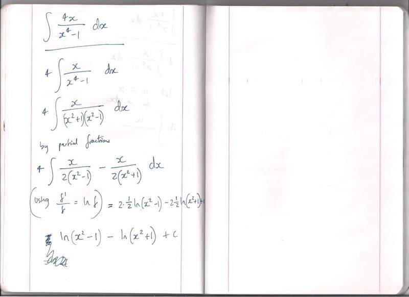

I'm trying to do this problem from S. P. Thomson's Calculus Made Easy
(see attached image file)
I've produce the answer here, but it seems to be different from the mathcad solution, which is:
ln(-1+x)+ln(1+x)-ln(1+x^2)
Could someone help me see if (and if so, how) my answer is equivalent (without the constant). If it's wrong, I'd appreciate a pointer as to why, and if there is a quicker way of tackling this problem than by using partial fractions, could you let me know?
Thanks in advance
Your answer is correct as is the books. ln a + ln b = ln (ab).
In fact, both answers could be written as
[tex]ln\left(\frac{x^2-1}{x^2+1}\right)+ C[/tex]
or even
[tex]ln\left(C'\frac{x^2-1}{x^2+1}\right)[/tex]
where C= ln(C')
Thanks! Nice to get one right for a change...
