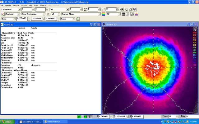

I had this image on hand, thought I would share it. This is a power cross section of a gaussian laser beam. Each color represents a power level. Other beam parameters are given to the left.
