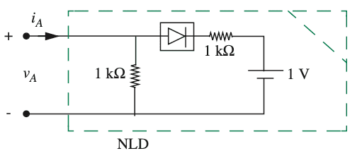

Plot the ##i_A## vs ##v_A## characteristics for the nonlinear network shown in Fig. 4.49. Assume the diode is ideal.
##i_D = I_s\left (e^{v_D/v_{TH}}-1\right )## (Diode)
I am quite stumped here.
This is what I did so far.

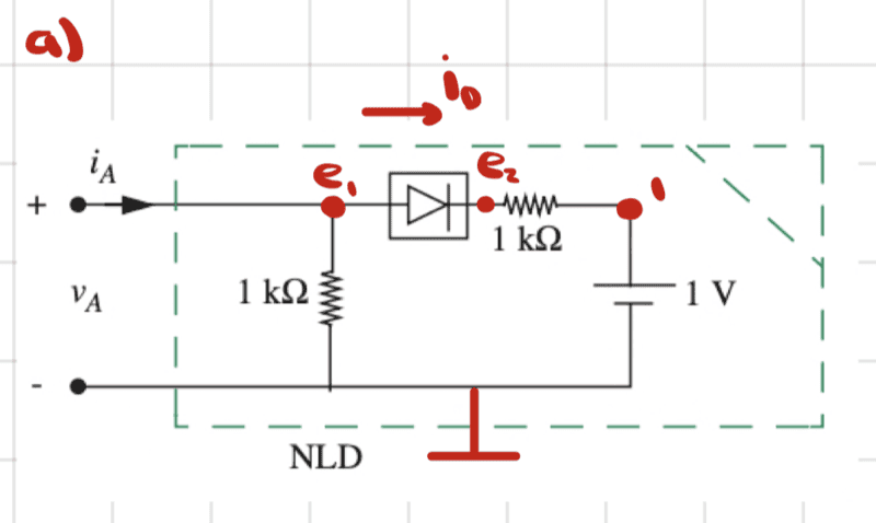

1) The first thing I did was to forget about the terminals to the left and the diode, and to write the circuit as a Thevenin equivalent circuit. Then I put in the diode. However, the terminals we are interested in are lost when we do this.
2) I then tried using the node method as follows
Here is the v-i relationship for the diode
##i_D=I_S\left (e^{\frac{e_1-e_2}{v_{TH}}}=1\right )##
and here is KCL applied to the ##e_1## node
##i_A-i_D-\frac{e_1}{10^3}=0##
##i_A-i_D=\frac{v_A}{10^3}##
We also have the v-i relationship for the resistors
##\frac{e_2-1}{10^3}=i_D##
##\frac{-e_1}{10^3}=i_D##
I'm a bit stumped at this point.

Do you have any clarification about what is meant by the part of the problem statement, "assume the diode is ideal"?
I'm asking because if I was instructed to assume the diode was ideal, I would assume that [itex]e_1 = e_2[/itex] (labeled in red in your diagram), so long as the current was flowing in the forward direction through the diode (and the diode is an open circuit otherwise). It makes the math a lot easier.
Modeling the diode using [itex]i_D = I_S \left( e^{ \frac{e_1 - e_2}{v_{TH}}} - 1\right)[/itex] is a somewhat/slightly idealized treatment of a practical diode, but it's not what I would call an "ideal diode."

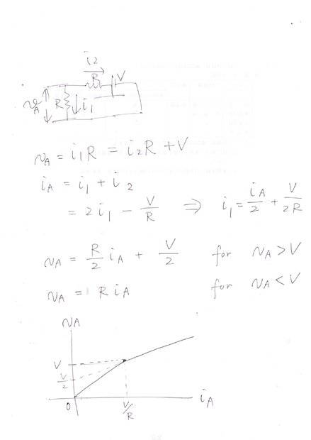

I observe that for ##v_A < 1V ## you can forget about right hand side part of circuit with diode, resistor and battery, so the circuit is with only 1 k ohm resitor,
[tex]v_A= 1000\ \ i_A[/tex]
Then you may proceed to the case ##v_A > 1V ##. When v_A is large
[tex]v_A \rightarrow (500 + 0)\ \ i_A[/tex]

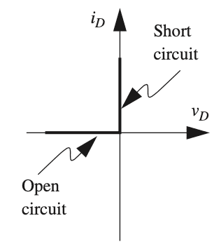

Here is what it is according to the book:
The ideal diode model is a piecewise linear model for the diode. It approximates the v-i characteristics of a diode using two straight-line segments given by
Diode ON (short circuit): ##v_D=0## for all positive ##i_D##
Diode OFF (open circuit): ##i_D=0## for all negative ##v_D##

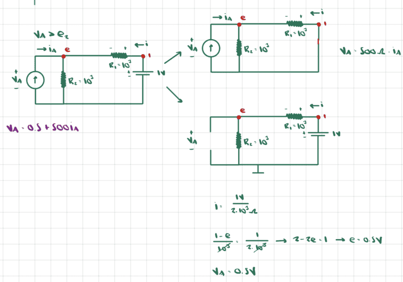

Here is an update on my next attempt at this problem
I considered two cases
Case 1) ##v_A>e_2##
When this happens then we can treat the diode as a short circuit. We can analyze the resulting linear circuit using techniques for linear circuits, such as Thevenin method.
Here are the calculations
The resulting relationship between ##i_A## and ##v_A## is ##v_A=0.5+500i_A##.

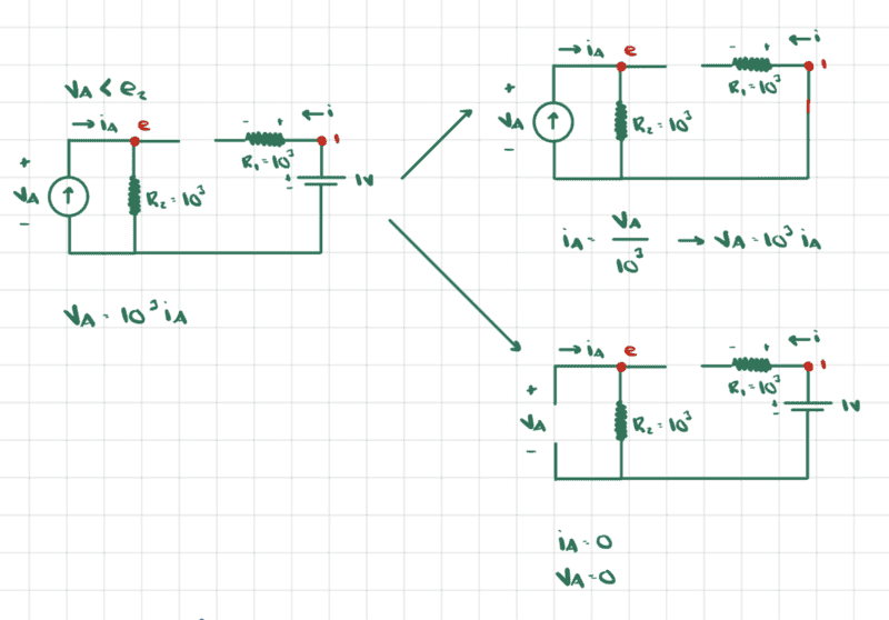

Case 2: ##v_A<e_2##
We can treat the diode as a open circuit and again use Thevenin method.
The result is ##v_A=10^3i_A##.
Note that in the thick of things i used Thevenin but after the fact it is clear that that was unnecessary (as anuttarasammyak had previously shown).
Thus we have two different linear behaviors for this nonlinear "ideal diode model" diode.
Case 1) ##v_A>e_2##
Case 2: ##v_A<e_2##
'Looks right to me. :smile:
