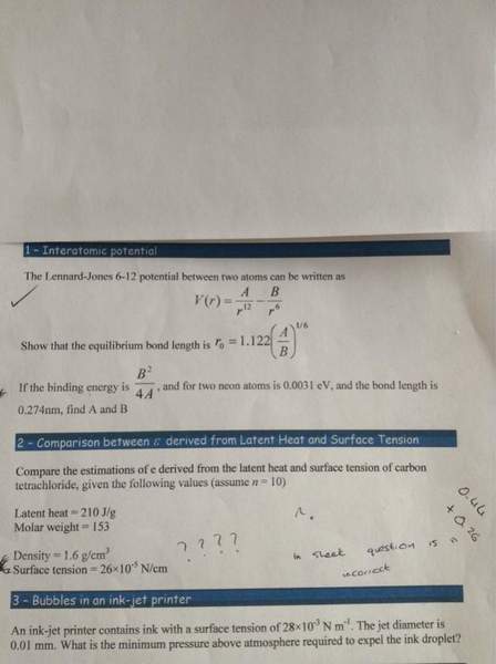

I have attached a photograph of my problem to save time on typing the question
I have done the first part to obtain the expression for equilibrium bond length and in the second part I solved that equation for A and substituted it into my binding energy equation and obtained an answer with the order of magnitude to the -60 so when I square it in my calculator I get 0, I'm assuming this is incorrect somehow although I don't see what I have done wrong
Thanks for any help in advanced, all necessary equations are present in the problem

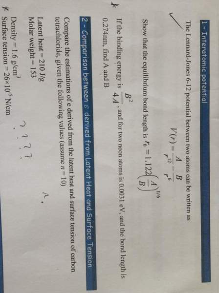

Broke my screen trying to read your picture without breaking my neck.
Please use the template. Read the guidelines to find out why saving your time typing is no good. Let alone breaking helpers' screens and/or necks!

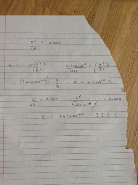

Show your calculations. Upright. Then we'll check :smile:
Sorry I will post another photograph and will take a photo also of my calculations just now
This is what I have got! But I keep getting A as 0
Regardless of how I do it my numbers are far to small
If your calculator can't handle these small numbers, you can always leave out the powers of ten, calculate, and then add the powers of ten again -- by hand ! Not so difficult, actually.
Work a little more neatly. ##B^2/{4A}## is not 0.0031, so B is even smaller than you thought. Let alone A !
Still, the answer is correct. Remember that 1/r0^12 is huge !
Ok I will give it a bash
Ok so I recalculated for A using B as just 2.63 and leaving out the negative power, I obtained A to be 557.81
Now my only issue is powers, when I use these constants in the first equation though just as they are they work, because the ratios are the same but they don't in the second equation
Sorry excuse my idiocy it does also work in the second equation :(
So my only issues is powers, one is to the negative 60 so if the ratio with the two numbers work then surely I have 557.81 to the negative 60 also,
Or
5.5781 to the negative 62?
To the negative 58 rather, as it is larger haha
Ok I redone all of my maths and wrote it out properly and got A= 5.576 to the negative 118When I put that back into my expression and used the laws of indices to make it simpler I got the correct answer which makes sense considering my powers which where then squared etcI do have a question regarding these constants? They are tiny... I mean an atom is what tens of femto metres so something to the negative 118 is over 100 orders of magnitude smaller

It's much easier to use nm as your unit for distances instead of meters that way you avoid having to deal with the powers of 10 all together.
Look at the units. A and B are not sizes. Their units are eV nm6 and eV nm12. You really should use nm instead of meters for that problem.
