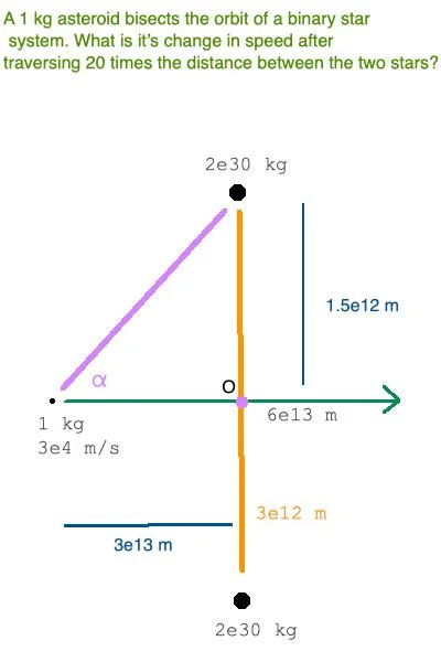

Has anyone solved a similar problem?
I came up with this problem several years ago, and decided I was too old and stupid to solve it. Just curious if anyone has seen such a problem.

Quick approximation: zero. It falls the same distance towards the binary system as it climbs back out, so there's no net change in its energy.
A more detailed calculation depends at least on the orientation of the plane of the binary components' orbits, and probably their eccentricities and the initial speed of the asteroid. It may well need a numerical integrator in general, unless anyone else knows more about test particle orbits in binary systems than I do.
Are you sure? As I read their (confusing?) diagram, the asteroid starts on the left at a distance of ##3\times 10^{13}\,\text{m}## but is evaluated on the right at ##6\times 10^{13}\,\text{m}## (twice the distance on right as on the left).
renormalize said:
Are you sure?
I read it as the blue line in the bottom left being ##3\times 10^{13}\mathrm{m}## and the green arrow across the middle being the twice that length. That's consistent with the total distance travelled being 20 times the distance between the stars, and adds that the distance is supposed to be symmetric about the barycentre. I think my answer is correct on that interpretation, but I agree other interpretations are possible and I would be wrong on yours.

We are given initial speed and position. We can assume a perfect circular orbit of the stars about each other. A quick look at the numbers says that the orbital velocities of the two stars exceed the initial velocity of the asteroid by a factor of three. The stars will have revolved more than once before the encounter gets interesting. This breaks the apparent symmetry. The asteroid will be deflected by whichever star it encounters first.
Without running the simulation, both a temporary capture or a quick ejection at an unknown angle with an unknown speed seem plausible.

What about the momentum? Shouldn't the stars both be attracted to the asteroid, move to the left and inward initially and then inward and to the right after the asteroid passes through the origin, O?
The stars orbit each other in a perfect circle. They also orbit each other such one star moves into the page while the other moves out. Thus the asteroid is always on a linear path.

I read it as the blue line in the bottom left being 3×1013m and the green arrow across the middle being the twice that length.
Correct.

...the orbital velocities of the two stars exceed the initial velocity of the asteroid by a factor of three
Sorry to laugh, but my calculations said that the asteroid's initial velocity exceeded the two stars velocities by a factor of 6.
Not only was I off by a factor of two, but the reciprocal to boot.
Ahhh, my mistake. I visualized all motion in the plane of the page. Your way restores the symmetry.

A more precise calculation, given that the asteroid is on axis, would be
  1. In the initial setup, calculate the position of the center of mass of the three bodies, which will be on axis and slightly to the left of the stars.
  2. The center of mass cannot move, so now you can calculate the position of the stars in the final setup, which will be slightly to the left of the center of mass.
  3. Compute the change in gravitational potential energy of the asteroid from the different distances. This gives you the velocity change.
You will likely find that you will need to compute ##\left((x+\delta x)^2+y^2\right)^{-1/2}## where ##\delta x## is much, much smaller than either ##x## or ##y##. Neglecting the ##\delta x^2## term$$(x+\delta x)^2+y^2\approx r^2\left(1+\frac{2x\delta x}{r^2}\right)$$so a Taylor expansion to first order gives$$\frac{1}{\sqrt{(x+\delta x)^2+y^2}}\approx\frac{1-x\delta x/r^2}{r^2}$$
Note that this is still neglecting any effect that the asteroid has on the orbits of the stars, but I expect that would be negligible compared to this already tiny number.

That clarification was in #6:

Would you be willing to double check that? I double checked a second source, and I'm still getting my initial answer.
Sure can. I have no reason to be very confident in my numbers.
We have ##F = \frac{mv^2}{r} = \frac{Gm^2}{r^2}## where ##F## is the attractive force of the stars for each other, ##r## is the stellar orbital radius, ##m## is the stellar mass and ##v## is the stellar orbital velocity.
Edit: One can see that I've screwed up this calculation. If ##r## is the orbital radius, the relevant distance for purposes of gravitational force is ##2r##. So we need to modify the above equation to:$$F = \frac{mv^2}{r} = \frac{Gm^2}{4r^2}$$
We can solve [wrongly] for ##v = \sqrt{\frac{Gm}{r}}## and take ##r = 1.5 \times 10^{12}## while ##m = 2 \times 10^{30}## and ##G = 6.7 \times 10^{-11}##
Edit: The corrected solution $$v = \sqrt{\frac{Gm}{4r}}$$
Double checking units -- kilograms, meters and seconds. No obvious problems there.
I get 9500 m/s this time.
Edit: Corrected to 4250 m/s.
Meanwhile the object is moving at 30000 m/s. So my revised estimate is that the stars are slower than the asteroid by a factor of three six. Not faster as I'd initially suggested.
