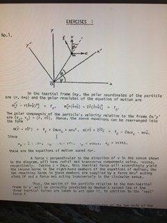

I already have the solutions emailed to me from a D H Lawden textbook. I have trouble understanding the solution as the solution is not formatted properly, and the answer seems to be a little too advanced for me. I hope that some one can help me understand the problem.

Ok. So I'm looking at the solution and I don't understand how they progress from mathematical argument to the next mathematical argument. Maybe I'm weak on polar calculus.
I'm going to attach the solution later, since I'll have to scan that specific solution from the big solution set that comes from the book. As I mentioned before, the answer is not formatted properly, but it might still be clear enough for someone with better expertise to examine.
And that isn't an attempt at a solution. You want to show your own work instead of dumping a picture on the folks who try to help you !
Yeah, start to work out the problem yourself. That helps more than staring at ready solutions!

I realize that I added a lot more variables such as t and (r', Θ), which made the solution more complex. Is it possible to simplify the problem using this method. The solution makes no sense to me.
Here is the solution.
