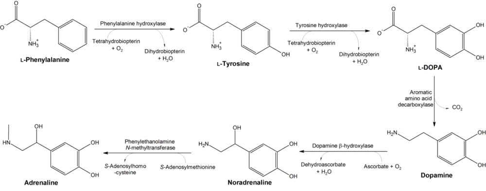

Astronuc said:
on the synthesis of adrenaline and melanin, they have separate (and different) pathways
Tyrosine -> Dopamine -> Melanin
Tyrosine -> Dopamine -> Adrenaline
How is this not the same pathway?
Astronuc said:
the synthesis takes place in different parts of the body
That's irrelevant, it has nothing to do with the pathway itself.

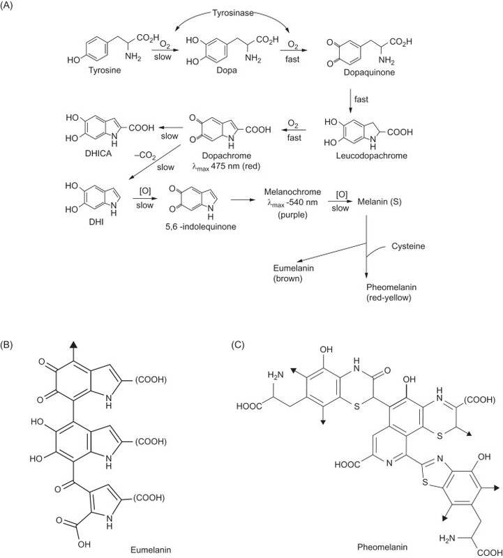

Different enzymes. See attached figures.
https://en.wikipedia.org/wiki/Tyrosinase
https://en.wikipedia.org/wiki/Tyrosine_hydroxylase
https://en.wikipedia.org/wiki/Dopamine_beta-hydroxylase
See also - https://en.wikipedia.org/wiki/Neuromelanin
Incorrect. It most certainly has to do with the pathways. Different cells, different enzymes, different pathways.
For my question it's irrelevant, because I'm interested in the relationship between adrenalin and melanin, which both have tyrosine and dopamine as their precursors. What exactly happens in between, such as different enzymes that are involved, that doesn't change the starting material or end product, and thus doesn't affect the relation between those two end products, because they still share the same starting material. And since my question is about the relationship between those two end products, coming from the same precursor, the specific enzymes that are involved in that pathway, and in what specific types of cell they take place, is of no interest to me, in regards to my question.
By the way, 'sharing the same pathway' aren't my own words, I read it in the link I shared earlier: "change in an animal’s stress response might lead to changes in pigmentation patterns via effects on shared biochemical pathways". But you're right in pointing out that it's not the exact same pathway, it's a detour indeed.

From @Astronuc
Basic Biochemistry
I was going to add a comment about the fact that once dopaquinone forms and is transformed to leucodopachrome, there is no relationship to adrenaline, except that it shares the same precursor, in different cells though. The indole structure makes it a very different molecule unrelated to adrenaline. Furthermore, the melanins are much more complex.
https://en.wikipedia.org/wiki/Indole
https://en.wikipedia.org/wiki/Melanin
