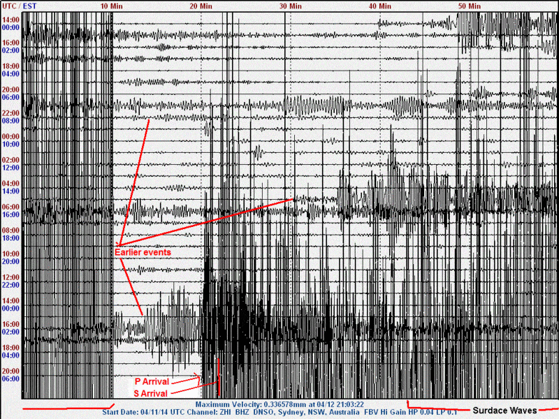

coming in on my seismo NOW
Southeastern Solomon Islands
initially reported as a M 8.3, since dropped to a M 7.6
But its still maxing out my main channel ( maybe it will go back up to ~ 7.8 ?)
http://www.sydneystormcity.com/seismograms.htm
cheers
Dave
Have had a text message from a friend on holiday in Vanuatu. He is in the town of Luganville on the island of Santo ( nthrn Vanuatu). His location is ~ 710 km SE of the epicentre.
It was felt by those present as a rolling motion.
cheers
Dave
Here's a screenshot before the signal started to overwrite the earlier trace
interesting that this event has so far not produced any large aftershocks

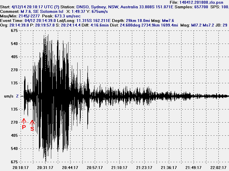

This is what the quake looks like once it has been saved and transferred into the Winquake analysis program
This is from a low gain channel that isn't maxing out the 16 bit AtoD converter

in the previous post of mine ... the second image ( the one from the analysis program)
look at the bottom line (immediately above the gram) starting with Org:
Org: = Origin time = 20:14:39 UT
P: = P wave arrival = 20:19:57.8 UT
S: = S wave arrival = 20:24:14.4
Diff: = S-P difference = 4 mins 16.6 sec
Dist: = Distance = 24.60 Degrees = 2734.9 km = 1699.4 miles
Mag: = magnitude 2 given -- ML = Local Magnitude and MS = Surface Magnitude
and finally
JB: = Jeffreys-Bullen Tables
WinQuake maintains three sets of P and S wave travel-time tables. Two are Jeffreys-Bullen (JB) tables, one set for teleseismic (distant events) and the other for regional or local events. The third set of tables use the IASP91 model of the earth. These tables are used to calculate the distance and the time of origin of the event. They are also used to calculate the location of the P and S markers if the event time and location are known.
From the Org and P info, you can see that the P wave took a little over 5 minutes to get to me
Ohhh and speaking of ML = Local Magnitude and MS = Surface Magnitude
ML was the original Richter magnitude scale Developed my Charles Richter and Beno Gutenberg at CALTECH in the 1930's. It was designed to be used with a particular style of seismometer, the Californian geology and for quakes out to ~ 100 km from the recorder.
It got hijacked by seismological institutes worldwide and adapted for their local geology and seismograph types
It uses the S-P time and the measurement of the amplitude of the largest waves on the seismogram ( in millimetres)
MB = Body wave magnitude using the maximum amplitude of the "body waves ( the P or S waves)
MS = is the Surface wave magnitude using the maximum amplitude of the "surface waves"
This is great for big shallow events, but useless for deeper events where the surface waves are very low amplitude. As you could now guess, the presence of large amplitude surface waves is a good indication of a
shallow < 50km event.
hope that's of help :smile:
