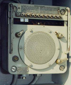

The old Ships intercom system (we had other NSFW names for it ) used the speaker as the microphone.
Reproducer
The reproducer serves a dual function. When it is
the transmitting station, it performs as a microphone;
when it is the receiving station, it performs as a normal
speaker; amplification occurs in the calling
The design was passed down from BSG. :DD
Battlestar-Galactica
