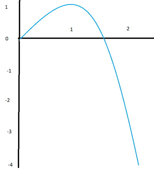

But surely we can do better than this crude guess. That function has a ##t^2## term in it. Its graph should not be a straight line. For a polynomial of degree 2, you need at least three points to extrapolate for a perfect fit. So let us fill in another point. ##v(1) = 4t - 3t^2 = 4 - 3 = 1##.
[Now let's see if my mspaint skills can render anything worthwhile. Less symmetric than it ought to be]
One can see that the average height of this graph is higher than for the first guess.
One might consider just averaging the three known, evenly spaced ##v## values: ##\frac{0 + 1 + -4}{3} = -1##.
