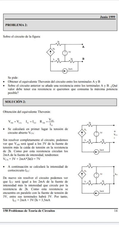

My homework says: "Which is the meaning of them?"
My homework says: "I" and "n" is "I" and double c.
I just need the meaning of In.

You'll need to provide more context. Perhaps a circuit diagram? We don't have your homework materials in front of us to look at, and we can't read minds!
I have found this in the Net.
So in that attachment they are looking at Thevenin equivalents. Despite the language issue, it should be obvious that ##V_{TH}## is the Thevenin voltage, ##I_N## would be the Norton current which is also the short circuit current ##I_{cc} (presumably the "cc" is an abbreviation for "short circuit" in that language).
