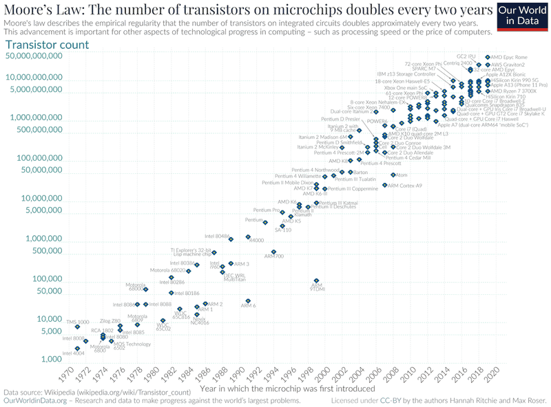

Sigh, I feel like Leonard on The Big Bang Theory who holds up the SARCASM sign. We don't have a sign or an unambiguous emoticon for SARCASM. Come to think of it, a SARCASM sign might be helpful.
In terms of the way people typically think of Moore's law, it ended about 15 years ago. That is when processors stopped getting faster. But as the graph indicates, Moore's law was really a statement about transistor density, and that is still increasing. But until about 2000-2005, chips were getting faster as they were getting denser, and that association is what ended. What it means is that we're not getting the improvements in computing power that Moore's law is associated with. More transistors theoretically means more power, but it's a lot harder to use them when operating in parallel than running linearly.
Nope. It actually has no specific reference to computers at all.
Moore's law is the observation that the number of transistors in a dense integrated circuit (IC) doubles about every two years.
Funny that the OWID plot doesn't slow down much after then. And of course I guess new innovations in computing. I wasn't too sure of quantum computing, but I've read up on some start-ups and also 'quantum exchanges' which try to do for quantum computers what early networks did for 'classical' computers. As far as their uses go, I've heard of at least one, which would be quantum encryption in satellites. Deterrence strategies on the satellite grid is high-priority, so it would be natural to employ if feasible. (If I have my facts right here, then I guess it is kind of amusing how deterrence norms drive progress.)

So...the first few words of the post were critical to it. And the wiki you linked does indeed explain why computing power and integrated circuits (which are what provide computing power to computers) are related:
...a prediction by Moore's colleague, Intel executive David House. In 1975, House noted that Moore's revised law of doubling transistor count every 2 years in turn implied that computer chip performance would roughly double every 18 months[31] (with no increase in power consumption).
