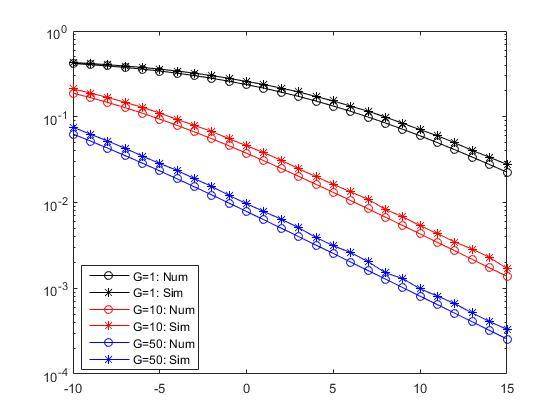

OK, now the integral is integrable, and Mathematica gives no complains. But when I compared the numerical results with Monte-Carlo simulations, where I generated ##10^5## samples for each point, I got very close but exactly the same curves. See attached Figure. My original equation is ##\varepsilon(\alpha_1,\alpha_2\alpha_3)=0.5\exp\left(-\frac{\frac{\alpha_1}{\alpha_2}G\gamma_Q}{\frac{1}{G}\alpha_3\gamma_p+1}\right)##. So,

Is there something wrong that gives me the difference between the two curves?

Attached is the figure. Sim=Monte-Carlo simulations
  • Log-scale plot (y-axis 10^-4 to 10^0) of curves versus x from -10 to 15, with black, red and blue lines for G=1, G=10 and G=50, each with Num (circles) and Sim (asterisks) markers; curves decrease as x increases.
I think Monte-Carlo simulations are accurate, so, I suspect, given that everything else done properly, the accuracy of NIntegrate in Mathematica is the issue. Is there any possible reason and I cannot see it?
Monte-Carlo convergence is quite slow, ##C/\sqrt N##, maybe the error is due to that. Also there could be some details that Monte-Carlo misses.
On the other hand how Mathematica does NIntegrate is hidden, it might also introduce some systematic error here.
I remember using Mathematica to evaluate some numerical integral in my master thesis. There was no difference between the numerical integration and Monte-Carlo simulations then!
