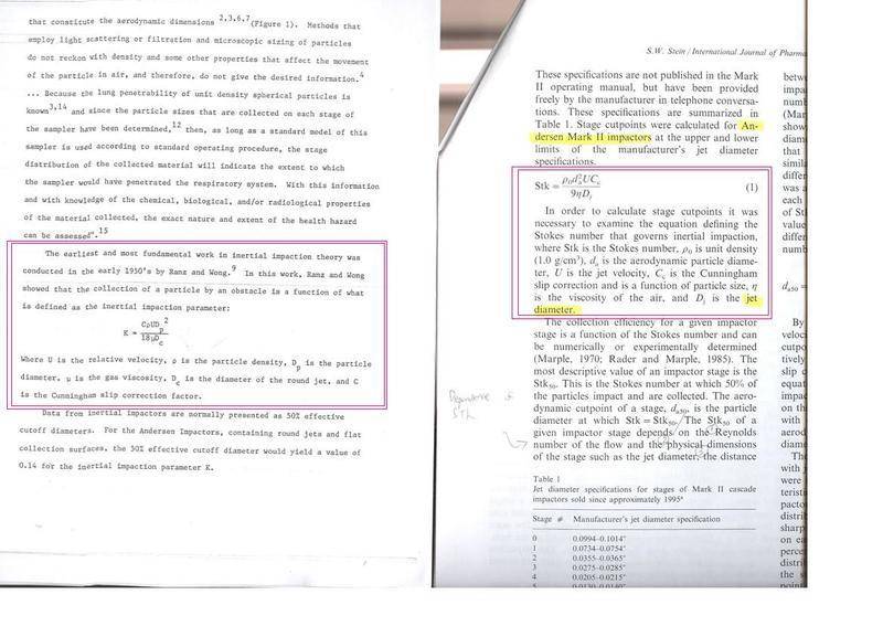

thx for answering
sorry for making 2 thread b4, cos after i created thread in here, i found that it should be more suitable for the thread created in the other forum and i am unable to delete the thread myself
I ve read some articles and found that ppl used either of the equation to describe the same thing. (anderson cascade impactor)
I just want to know what's the difference between or how they are derived from each other.
here is my question come from
as both of the equation is similar, I've tried to proved that inertial impaction parameter is same as stoke number
i converted the particle physical diameter dp in equation on LHS from the pic attached into aerodyanmic diameter, da.
But still, the equation is not the same as on RHS.
or did i missed out sth
im so confused:frown:
