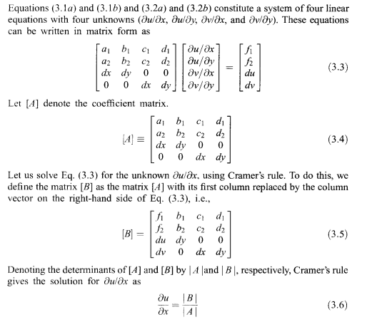

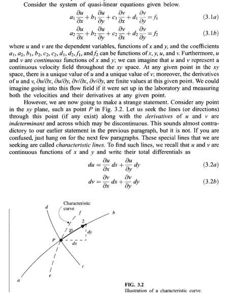

I am learning about PDE classification from a text on CFD (by Anderson). This section is not complete enough to be able to extend his example problems into more general cases. I read that to classify a system of PDEs as being parabolic, elliptic, or hyperbolic, I need to do some crazy stuff with Cramer's rule. However, the examples that he has shown are 1st order PDEs and like I said, are *systems* of PDEs. Now I have been asked to show that the 1D heat equation is parabolic and I am not sure how to apply what I have learned since a) it is 2nd order and b) it is only 1 eqaution:
[tex]\frac{\partial T}{\partial t} = \alpha \frac{\partial^2 T}{\partial x^2} \qquad(1)[/tex]
Cramers rule
I thought that I could form a system by forming the total differential of T(x, t)
[tex]dT = \frac{\partial T}{\partial x} \,dx + \frac{\partial T}{\partial t} \,dt \qquad(2)[/tex]However I am not sure if this is helpful. Any hints?

Hi LCKurtz :smile: I actually found that at wolfram as well. The problem is that he does not use that in the text (explicitly). I think what he has done is kind of derived that equation, but in a less general sense. I am just trying to learn a little more about where that equation at the wiki comes from. Let me show you in broad terms what Anderson did on his example:
The starting point:
Putting in matrix form:
He then set's det(A) = 0 in order to get a quadratic algebraic equation in (dy/dx). If the discriminant of this quadratic meets certain criteria, we can classify the PDE as parabolic. I am just having trouble putting everything into matrix form since I don't have a system of PDEs (unless I was right by taking the total differentials in post #1).
