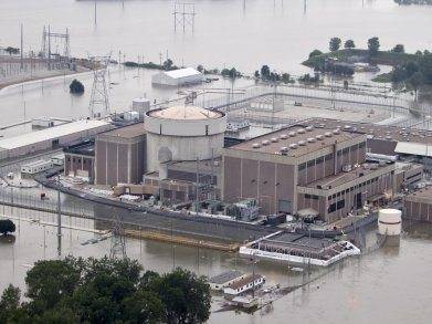

I know several people who work at the plant. They are very dedicated to their work, their families and their community.
The article cited in the OP is pure crackpottery (link to article was deleted per PF Guidelines).
http://www.oppd.com/AboutUs/22_007105
OPPD said:
  • The FCS plant’s reactor has been in cold shut down for a planned refueling outage since April 9. It will remain in that condition until the river recedes.
  • The reactor and spent-fuel pool are in a normal, stable condition and are both protected; there has been no release of radioactivity and none is expected.
The plant is actually designed with greater flooding (1014 feet above mean sea level (MSL)) based on an upstream dam burst and additional rain locally.
The utility is expecting a peak river elevation of up to 1008.5 feet above sea level and has taken action to protect the switchyard and other capital assets from a greater flood.
There was an NRC action last year and the plant revised their flood protection program to address what the NRC considered deficient.
http://pbadupws.nrc.gov/docs/ML1109/ML110950135.pdf
http://pbadupws.nrc.gov/docs/ML1113/ML111370123.pdf
http://pbadupws.nrc.gov/docs/ML1019/ML101970547.pdf
http://pbadupws.nrc.gov/docs/ML1003/ML100351342.pdf
http://pbadupws.nrc.gov/docs/ML0936/ML093641134.pdf

Rumor: Because of a fire at Fort Calhoun Nuclear Station on June 7, the plant’s spent-fuel pool was in danger of boiling and releasing radioactivity.
There was no such imminent danger with the Fort Calhoun Station spent-fuel pool.
Due to a fire in an electrical switchgear room at FCS on the morning of June 7, the plant temporarily lost power to a pump that cools the spent-fuel pool.
The fire-suppression system in that switchgear room operated as designed, extinguishing the fire quickly.

NPPs have mandatory restrictions based on safe operation of the plant as well as environmental restrictions. These are found in the plant FSAR or updated FSAR.
Plants on the Atlantic and Gulf coasts normally shutdown if there is a hurricane within a certain distance from the plant. Plants where flooding occur, such as those on the Mississippi and Missouri Rivers would go to standby or shutdown depending on the water level. Shutdown means that decay heat would be removed under normal procedures.
The plants are following normal procedures regarding shutdown. Ft. Calhoun was already shutdown, while Cooper has been operating. They will shutdown the plant if the flooding reaches a certain level. Meanwhile, they will monitor the flooding with the Corp of Engineers.
Below are links to the National Weather Service's river prediction center. The gage at Blair, NE is a couple river miles north of the plant so be careful about making assumptions related to the elevation at the plant. It does provide a general outlook for the area. The gage nearest Cooper is the Brownville gage also linked below and the same care should be taken regarding exact elevation calculations.

The following NY Times article provides a good insight into the safety issues at Fort Calhoun and the interaction between the NRC and the plant operator : "A Nuclear Plant's Flood Defenses Trigger a Yearlong Regulatory Confrontation" By PETER BEHR of ClimateWire Published: June 24, 2011 http://www.nytimes.com/cwire/2011/0...defenses-trigger-a-ye-95418.html?pagewanted=1
Edit (sorry I meant the 24 June article not the 20 June article http://www.nytimes.com/2011/06/21/us/21flood.html?_r=1 as I previously wrote : I was confused with my bookmarks)
Astronuc's third document, http://pbadupws.nrc.gov/docs/ML1019/ML101970547.pdf, and this story, A Nuclear Plant's Flood Defenses Trigger a Yearlong Regulatory Confrontation suggest that OPPD and the NRC had some very interesting interactions with each other over the past year.
Apparently, OPPD didn't agree with the NRC's risk analysis (i.e. - the chance of a flood being higher than what Ft Calhoun had protected for) and the OPPD made almost facetious changes to their protection plan:
OPPD planned to extend the barrier to 1,014 feet by stacking sandbags on top of some steel floodgates that protected the auxiliary building, and to use more sandbags to safeguard the water intake structure and its essential cooling water pumps.
The NRC inspectors rejected that strategy. "The sandbagging activity would be insufficient," the NRC concluded in a July 15, 2010, letter to OPPD. The half-inch cross section on the top of the floodgates was too small to support a 5-foot stack of sandbags hit by swirling floodwaters, the agency said.
They seriously thought they could stack five feet of sandbags on top of a floodgate with a 1/2 inch cross-section? Astronuc's document talks about this, too, and the NRC inspectors requested a demonstration of this plan. I wish I could have been there for that. :smile:
The AquaDam (which you can see in the picture in the original link) is an interesting solution. Usually, those are used for temporary construction projects, but I guess there is a certain flexibility in using them for flood protection. The barrier can be removed when it's not flood season (so the fact that the dam was installed just days before the flood may not indicate that they were lucky to avoid disaster).
OPPD has made significant changes to their flood defenses between last fall and this summer. All of the floodgates that previously protected to 1009.5' msl (and that required "draped" sandbags) were replaced with new gates that protect to 1014'. The actual NEW procedures (post yellow finding from NRC) do not even call for the use of AquaDams. The AquaDams are there to provide additional protection from flood water.
OPPD also has a significant head start at decay heat removal due to the plant being shutdown since April 10th for a refueling outage. Astronuc may have to correct me, but I believe for that amount of time there is around 0.015% of rated power left as decay heat. Contrary to many claims online, OPPD utilizes dry cask storage so the spent fuel pool is NOT "overloaded" with spent fuel rods. There still is a sizable amount of decay heat, however it is orders of magnitude lower than what the pumps are designed for.
The electrical switchyard (offsite power) is protected by an earthen berm. Besides the two installed diesel generators, an additional industrial size generator was brought into provide greater defense in depth. Two additional LARGE fuel tanks (in addition to the 20,000+ gallons that are always stored onsite) were brought in for further safety margin.
While the plant may look scary on the news, always check the facts before trusting a journalist when it comes to anything nuclear related.:smile:
