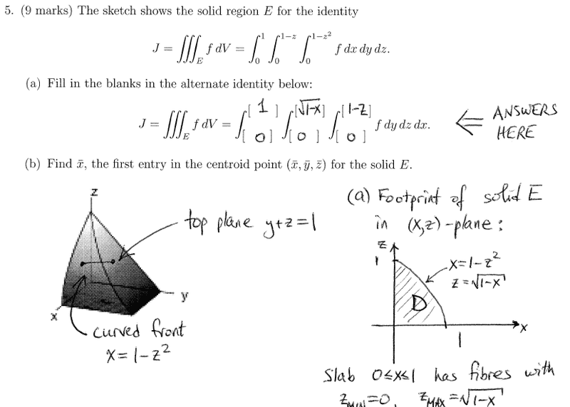

Here is the question along with the solution and sketch.
Handwritten sketch of the (x,z)-plane footprint of solid E: a shaded region D bounded by the curve x = 1 - z^2 (z = sqrt(1 - x)), the axes and x = 1, with slab limits 0 ≤ x ≤ 1 and z from 0 to sqrt(1 - x).
I think the sketch is wrong because the projection in the xy plane shows a rectangular box. I don't think it is a rectangular box because you can solve for an equation relating x and y.
You know that y = 1-z and x = 1-z^2, so you can solve for some equation with x and y by eliminated z. Which gets you x = -(y-1)^2 + 1 for the relationship in the xy plane and it is clearly not a rectangle...?
That last equation is, of course, x= y(2- y) but it is the projection of the boundary of the y= 1- z and x= 1- z^2, NOT the base itself. The sketch is correct.
