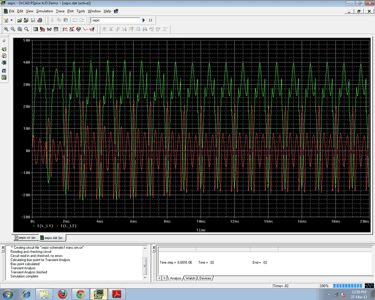

hello everyone,
I am designing Single ended primary inductor cell(SEPIC) converter. the objective is to get output voltage from 5V to 20V and 1 A current when we change the duty cycle of the pulse supplied to gate of MOSFET. when i simulated the circuit in proteus MOSFET is unable to turn off. I researched about snubber circuits as well but it didn't help me. Is there any snubber circuit for SEPIC converter? My calculation and simulation results are attached with it. please have a look and please help me.
thank you
That's a big circuit. I'll solve it but it will take time. So, be patient. OK?
ok thankyou
I've simulated your first circuit in pspice and I don't see any problem.
However the output current I got was 35mA.
Below is the SPICE code I used.
The diode and mosfet models are taken from datasheets.
