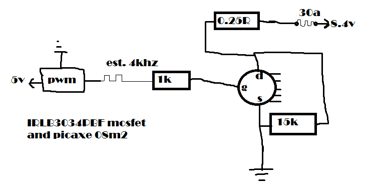

Ok, so i have a picaxe microcontroller putting out a pwm signal to the gate of an irlb3034 "logic level" n-channel mosfet.
The mosfet is for grounding on and off about 8v of 20 to 40 amps.
When i take my circuit and jump 8v directly to the gate of my mosfet everything works perfectly and the circuit works great. But when i use the digital 5v signal (even at 25% duty cycle) from my picaxe the mosfet transistor gets VERY HOT and i have already blown a few of them although i do read the pwm signal on my scope from the load which means it is technically working.
Any ideas??
Check the pulse rise and fall times on the gate. They are probably rather slow, keeping the FET in the linear region for extended periods. The gate acts as a capacitor of 1 to 10nF, thus requiring signifcant drive current for fast switching.
Also, what is the pulse rate and duty cycle? Or equivalently, ON time and OFF time.
Can you post a schematic, at least the FET gate drive and the load?

showing us your circuit would be very helpful and would stop people playing the 20question game till we figure out what you are doing :smile:
As for a schematic is there a program that you guys use? I agree it would benefit everyone especially me. I normally just draw mine but this is important to me and ill give you whatever is needed.My scope can't seem to latch onto the frequency but every time i turn it on i can hear almost exactly 4khz coming from my circuity and i have it set at roughly 50% duty as of right now. I measured the voltage directly on the gate pin and it hits exactly 5.0vI did put a 220 ohm resistor between signal and the fet gate, as i have seen used in other schematics, showing no improvment but ill probably leave it thereHonetly it seems as if the fet is acting like the signal voltage is bellow threshold, and yet the datasheet says threshold voltage is well bellow 5v, because oddly enough 8vdc works perfectly fine for switching it on.
just draw a tidy image in MS paint or what ever your computer has , save as a GIF and upload it.
keep the longest dimension to a max of ~ 800 pixels

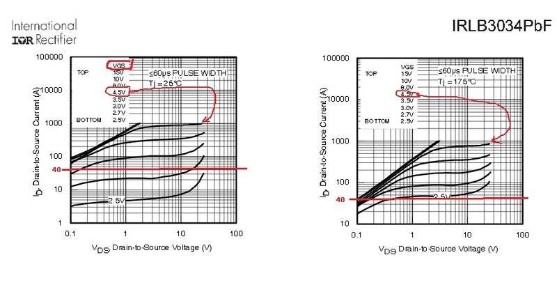

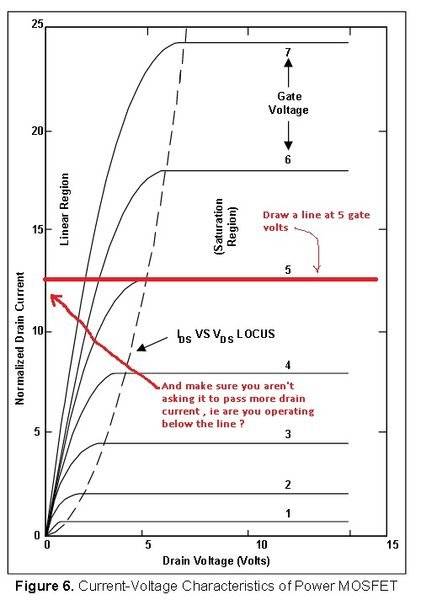

Find the datasheet for your mosfet.
It should have a graph that looks something like this: (annotations mine)
https://www.infineon.com/dgdl/mosfet.pdf?fileId=5546d462533600a4015357444e913f4f
Then measure drain voltage when it's conducting. You need to be on the right hand side of that 5 gate volts curve. Else it'll get hot.
Could be you need a little more gate voltage. You said 8 works fine.
It's late here so I might be wrong but I think you mean it should be on the left hand side of the chart when conducting (eg Low drain-source voltages).
Tesladude said:
I can not seem to find a similar graph on my datasheet
I think it's Fig 1 (25C) and 2 (75C) on page 2 (They have a log scale so looks a bit different to the one Jim posted).
Fig 1 says at 25C, with a 4.5V gate voltage and 30A drain current the drain voltage will be <0.1V so power dissipation is going to be < 3W. Pretty much same at same numbers at 75C.
That's also consistent with an Rdson of 2 milli Ohm at Vgs = 4.5V
0.002 * 30A = 0.06V

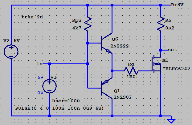

Tesladude said:
With that said, will putting the p-channel version of my mosfet cause any issues that may be going over my head?
Usually a high side driver is referenced to the +ve power rail, so level shifting is needed. For low voltage supplies the NE555 can do that level shifting, but it inverts the signal.
It costs less, is cooler or more efficient to switch a high current with N-channel mosfets, so you could avoid a P-channel mosfet by using a non-inverting complementary follower in place of the NE555. See the circuit attached.
Rpu is a pull-up resistor, it may be needed to make the output approach the positive supply.
Rg is there to stop oscillation during transition, the peak gate current may be limited by the transistor current gain.
Transistors are selected for a high collector current, over 500 mA.
Output voltage is slightly reduced by ±Vbe, but that is not usually a problem with logic level mosfets.

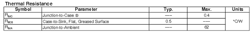

Tesladude said:
but according to the graph switching such a high current caused a relatively high voltage drop (Vds= voltage measured across drain and source?) due to the internal resistance of the mosfet which of course came off as heat.
Datasheets are wonderful things !
The graph tells me you will have less than 0.15 volts across your MOSFET if its gate gets to 4.5 volts.
At 40 amps that's six watts, so you WILL need a small to medium sized heatsink.
Junction to Ambient tells how hot it will get with no heatsink, degreesC rise per watt.
Six watts is 372 degrees with no heatsink.
(Did we all miss that ?)
You'll want a heatsink rated less than 10 degrees per watt . Less RThermal is better
Hands up I missed it. Particularly the RJA of 62C/W
