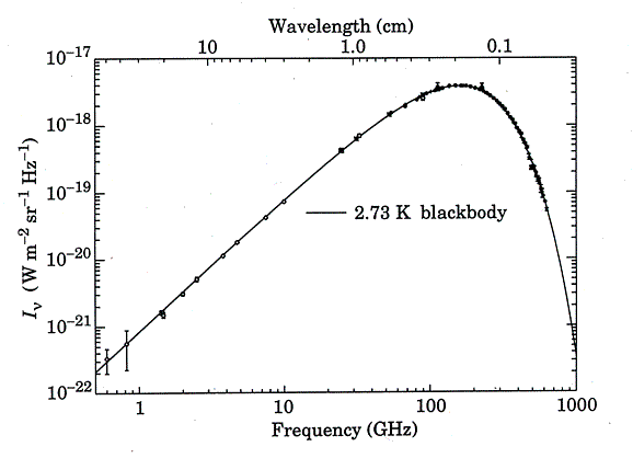

they found a kind of lop-sided bell curve covering a range of photon energies. The temperature corresponds to the peak of the curve by a formula named after herr doktor Wien (pronounced "veen")
There were plenty of photons below the peak.
I basically am of same mind as Vanadium.
If they kept building and launching larger colder more sensitive antennas and receivers looking for lower energy longer wavelength photons, I expect they would keep on finding radiation but it would keep on fitting the SAME LOPSIDED BELL CURVE, that we already have, with the same Wien peak and bespeaking the same temperature.
That is just the way black body radiation is. Generic radiation from something at a given temperature, it is a kind of bellish mix. You can't "run a map at a lower temperature". You have to run a map at lower frequencies and see what temperature Nature gives you, what shape curve.
There could be a surprise though. The surprise would be if there were an unexpected little BUMP on the curve, which they discovered as they were exploring lower frequencies and longer wavelengths. That would certainly represent new physics and new cosmology. Nobody expects that. There is no reason AFAIK there should be anything in the Background of Ancient Light besides the redshifted glow of the hot gas circa year 380,000---a glow which fits the Planck black body curve with remarkable precision. It would be a shock t discover a second little peak in a range frequencies lower than have been explored yet.

...it would keep on fitting the SAME LOPSIDED BELL CURVE...
Marcus, Is this curve the "power spectrum" representation that is frequently shown?
Regards,
Noel.
Regards,
Noel.
Yes, black body power spectrum. The curve can be be plotted either with frequency on the x-axis or with wavelength on the x-axis. They are reciprocals so naturally the shape is different. the curve looks the same shape for every temperature only it is skootched over to the right or left so the peak comes at a different place.
the study COBE discovered that the cmb has an amazingly accurate fit to the black body power spectrum. Everybody was astounded, at the meeting where they first showed the slide, the audience immediately rose and gave them a standing ovation. Now we take that fit for granted but in the 1990s it was astonishing.
Max Planck discovered the formula for that curve right around 1900.
95-some years later the satellite COBE (cosmic background explorer) found that the most ancient light in the universe has that exact shape
Thanks again Marcus. Just so that I'm clear / can confirm; at very very small variations (in frequency /wavelength, which are representations of temperature variations) from the CMB there's also radiation, and the only quantity of radiation at these small variations is that needed to "complete" the power spectrum curve. Is that correct? (As I write that, my words sound very doubting, and that's not the intention, I fully accept and appreciate that the calculated curve represents a very detailed / specific prediction, which has been completely born out by observation. I'm just trying to understand the observation at the CMBR temperature versus the observation that would be made at 0.5k higher than the CMBR or 0.5k lower than the CMBR.)
I think you misunderstand what the power spectrum curve means. The CMB is not a single frequency, but a spectrum of frequencies. The power curve simply tells us how much power we receive at each frequency. See the graph below.
Note how the curve peaks around 100-200 GHz, yet we still see radiation at frequencies higher and lower than this. It is this specific shape of the curve that corresponds to an object at 2.73 kelvin. An object that is hotter or colder would have a different shape and would emit different amounts of radiation at each frequency, but would still emit all across the EM spectrum.
Play with the calculator here: http://lamp.tu-graz.ac.at/~hadley/ss1/emfield/blackbody.php

Darkkith, If I use the calculator that you linked to and plot the graph for 2k, 2.3k, and 3k, I can see that (for example) the frequency of 2000μm appears for each, however, the power obtained for that frequency varies for each plot. So, is an experiment like CODE measuring the amount of radiation with a specific frequency and a specific "power" to obtain power spectrum?
And (assuming the last statement was correct), maybe I could ask a followup ... I thought that power was determined by frequency (i.e. that a specific frequency always has a specific power) - is it energy, not power, that is determined by frequency (and can you recommend any reading on the difference between energy and power)?
Thanks again in advance,
Noel.
You mean COBE? It measures the amount of power from each frequency. It doesn't look for a specific amount of power, it simply measures whatever is coming in.
I think you're referring to photons here. Each frequency will interact with matter with photons of a specific amount of energy. The higher the frequency, the more energy each photon has. Power is energy over time. For example, if we have 1 joule of energy being deposited into the detector every second, then we have 1 watt of power. Two joules of energy every second would be two watts of power.
