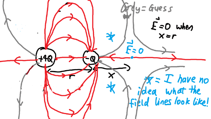

I have attached an image of what *I think* the electric field looks like. Would this be correct? I am convinced about everything here, apart from the ones on the far right. All the other ones loop from the +ve charge to the -ve charge, but where do the grey lines on the right loop to (the ones that point to the right)? One thing I can think of is that they come from infinity and don't loop from anywhere!

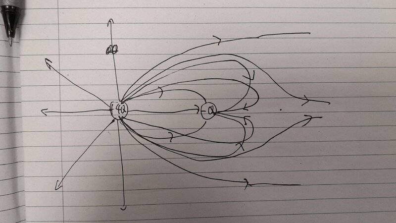

Good point - ignore some parts of my diagram then :D. That ruled out one possibility. However, there are two left - do the electric field lines on the left hand side go to infinity on the LHS, or do they flip at some point and go to infinity on the RHS?
As I wrote in post #8, your original diagram was essentially correct. You just need to arrange that only about a quarter of the lines from the left pole reach the right pole.

I don't think it was correct after playing around with the electric field thing.
I tried that link and it seemed to me it confirmed the essential features of your diagram. The curves are rather different, but that's less important.
Where do you think your diagram looks wrong?

True, the two grey lines on the right look like they are converging when they should eventually be diverging. But arguably that's just because the picture doesn’t go far enough in that direction, no?
Perhaps, but that feature is arguably so important that if it the picture is not drawn so far out that it is obvious, then it should be extended.

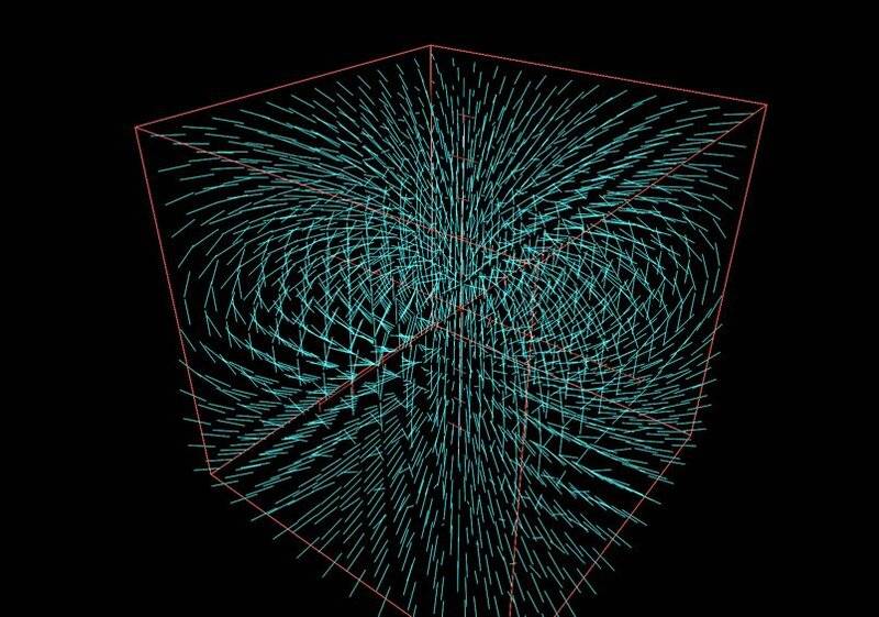

Shown below is a 3d plot of a dipolar field that I generated with grapher.app on my mac laptop. It might be a more correct representation of the filed on a 2d surface but there is too much clutter for my taste.

The rightmost grey lines. Also - I think my curves were kinda off.
It's tough to get the curves accurate without a lot of calculation. But you can correct the asymptotic appearance of the lines by ensuring they look more like the field from a single charge.

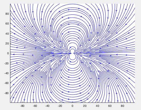

I had trouble creating a field line density plot for the case where the left charge has four times the magnitude (but opposite sign) because as soon as I made the charges to the values of the charges in my script the whole thing went haywire. I would agree that field line density should be more around the bigger charge.
In the meantime here is one I created for a physical dipole where both charges are equal in magnitude but opposite in sign.
I created the field in 3D and used the "streamslice" feature in matlab for the plane ##z=0##. Surprisingly "streamslice" does better at creating field line plots than "streamline". For the case of two equal but opposite charges "streamline" was giving me all sorts of problems but "streamslice" by default gave me a good picture without me having to tinker with the settings/options.
I may have to do some tinkering with "streamslice" for the case of one being +4Q and the other being -Q.

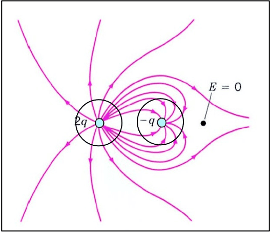

kuruman said:
I found the figure below here
http://www.phys.nthu.edu.tw/~hf5/EM/lecture note/EM02.pdf
The black circles are my addition. Note that twice as many field lines exit the circle surrounding the +2q as enter the circle surrounding the -q charge.
That’s not really accurate though. Close to the charges the field lines should be distributed as for a point charge (the point charge field dominates as it grows to infinite strength). In this picture they are not.
The figure is also mossing the effect talked about earlier in the right part. All in all, not very accurate.
Edit: Another obvious error is that, since the overall charge is q, a flux corresponding to q should exit to infinity. This also means that a flux corresponding to q should go from the 2q charge to the -q charge, which in turn means that for the field lines exiting the 2q charge the boundary between those field lines that reach infinity and those that end up in the -q charge should be vertical in the picture. They clearly are not.
Edit: As explained, your @laser's initial diagram is largely correct. The improvements that could be made are:
  • ensure that lines heading off to infinity appear to diverge; specifically, the two grey lines going off to the right, having converged initially as shown, should then diverge
  • those two lines do not seem to have an origin; it should show where they emerge from the larger charge
  • the picture should extend far enough to show the path of those two lines from where they leave the 4Q charge to where they converge then diverge on the right
  • add more lines emerging from the left and heading off in different directions, so that the viewer can see how, on zooming out, it starts to look like a monopole field
