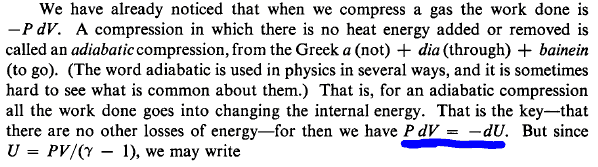

i found this while studying :the kinetic theory of gases.
the thing is thermodynamics comes afterwards , and i found this

Yes it is. Just out of curiosity , which text is this ?
Likes AyoubEd
this "the feynman lectures
Likes Useful nucleus
do you want a link
No thanks , a lot ! These are very famous. Feynman's comment about how "adiabatic" is used in many contexts caught my attention. I always had difficulty associating adiabatic in thermodynamics to adiabatic in quantum mechanics.
