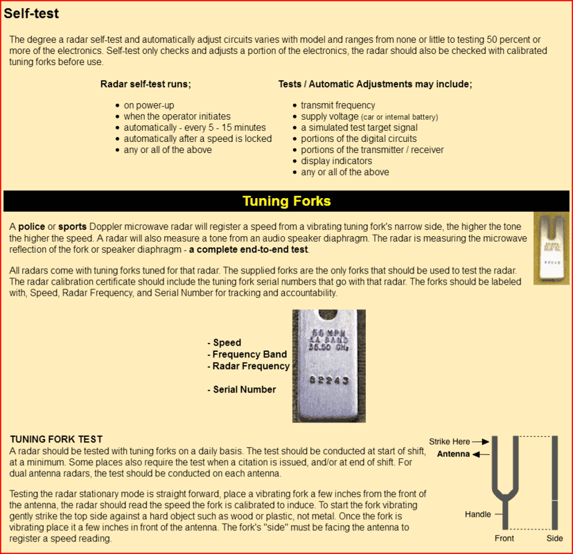

I'd never seen this before, so I searched a bit on the Internet this morning, and indeed it does look like audio tuning forks are a standard way to check the calibration of a radar gun. But in the link I show below, they say to hold the tuning fork so that the thin side is toward the radar gun, which makes sense to me since that is the direction of the vibration.

https://copradar.com/chapts/chapt3/ch3d4.html
Web page section titled Self-test on radar self-tests, with a Tuning Forks heading, a photo of a tuning fork labeled Speed, Frequency Band, Radar Frequency and Serial Number, and a diagram of a tuning fork test showing front and side orientation.
I don't have any experience with this, but it seems like you are correct.
Seeing the tuning fork (this one is labeled as "55 MPH") reminds me of a magazine article I read back in the 1970s, on how to beat speeding tickets. One idea was, if your cited speed is a multiple of 5 MPH, to ask the officer (in court) what the calibration tuning forks read. So if you are cited as 75 in a 55, maybe you can get the officer to say he has a 75 MPH tuning fork. The idea is, to break the logic that says the only way the radar display will show "75" is if you were, in fact, going 75 MPH. I'm not sure this would actually do anything other than irritate the judge, but it is how I learned about the tuning forks.
I believe you are correct about the way to calibrate a radar gun but I suspect the unit is sensitive enough to detect the vibration even when the tuning fork is held nearly orthoganally.
"Incorrect" fork position would result in additional attenuation of modulation of reflection by up to 20dB (~100 times). Typical radar receivers at point-blank range have dynamic range margin above 80dB (100,000,000 times), therefore angle of fork during test is not important at all.
