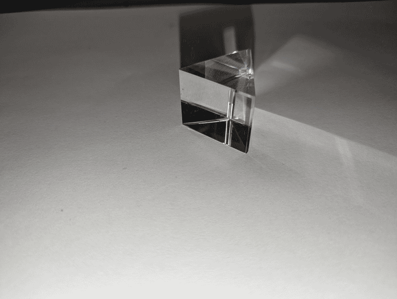

It's actually hard to photograph, but this is what I'm using, and you can see the tiny band of yellowish on the far side, but this is from a 'white' led.

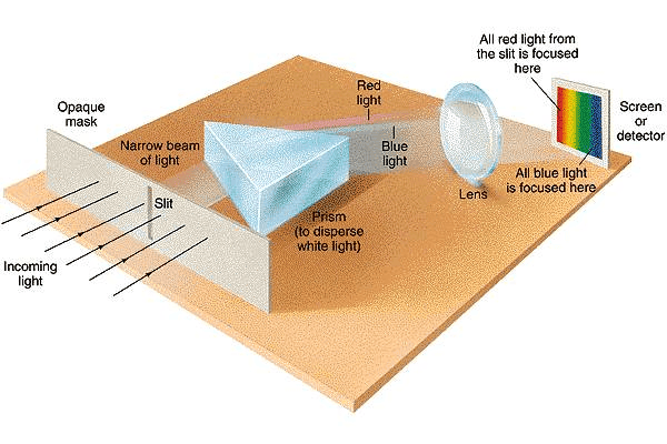

I think you need collimated light for the prism to give separation of the colors. The prism will bend colors at different angles, but if there are many incident angles, the end result will be smeared out. You could try putting a narrow slit in front of the LED. This will block all "off-axis" radiation from your light source.

Yes @Newtons Apple, as @DaveE suggests, the light should be made more parallel by passing it through a slit, and further improvement is possible by using a lens to produce a focused image:

Right Of course. A narrow slit is usually required.
Ahh maybe that's it...I did use sort of a focused light, but it wasn't *that* narrow...Thanks guys will give it a try!
It's a good idea, and probably necessary, to project the light onto a white screen of some kind.

If the light is sufficiently bright, you could still just use a slit (in a darkened room), but if not, you could remove the (hypothesized) dispersal lens to get better directionality.

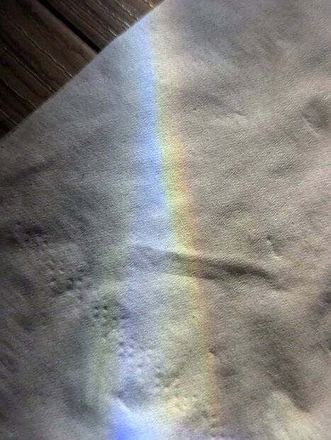

Thanks! I had to do this multiple times, but I think I finally got a good baseline result.
So this is from a "Full spectrum" LED light. I confirmed that use the Blue Light with Phosphor Coating to produce their white LEDs. I bought some black poster board and cut out a pretty narrow slit on it and got the prism to disperse it. This is a clear as I could get after multiple attempts. It's definitely a rainbow..but it's missing green completely it looks like, and no real orange:
What's now tickling my curiousity...is just how can blue + Phosphor even create *this* much variation in color...
So I suppose this satisfies me. It's not a complete, continous spectrum that you'd see from the sun, so calling it 'full spectrum' may be some marketing over selling I'd think...but it *is* there
Is that ... tissue paper?
You'd great lot better result with something hard and glossy, reflective white.
