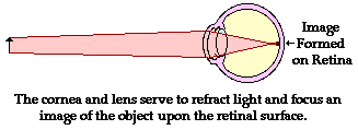

Here are a couple of additional pictures. (I have collected several of these, trying to puzzle it out). In one illustration, there seems to be a tiny but perceptible divergence of the rays, just at the retina. This would make sense, because it would plant the image on the fovea, a tiny pit packed with cones. (Without the fovea we are blind).

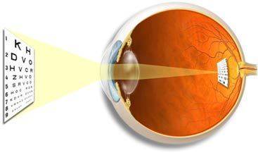

In the other picture, the one imaging the eye chart, I can't make sense of what is happening. It seems as though a chart of that size could only be imaged on a screen somewhere deep behind they eyesocket.
I guess I would vote for the first picture, but the divergence of rays shown is so tiny it might be my imagination -- I guess I want one to be there, to be consistent with my own understanding, or misunderstanding, or how an image is formed.

It's not where the focal point is located, per se, it's where the image point is located, that matters. If the object is at infinity (or at least very far away), the image is at the focal length (or located very close to the focal length) away from the lens. If the object is close to the eye, then the focal point is somewhere inside the eyeball, and the image point is still at the retina.
Keep in mind is that the eye lens changes shape according to the tension of the muscles that surround it, thereby changing the focal length of the system. That's how we can focus on objects at varying distances without changing the image distance, which is fixed because the eyeball is in a bone socket. This is called accommodation. If you're looking at something clearly, then the image must be at the surface of the retina, or at least close enough that the blurring is small enough not to be noticeable.
Neither of your two most recent diagrams is an accurate ray diagram of the type you'd find (or should find!) in a physics book, by the way. The diagram in the earlier posting, is more accurate, at least for a pointlike object at infinity.
