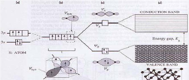

i read a book which says the orbital 3s2 and 3p2 can form hybrid orbital. This orbitals (when Si atoms are put together in crystal) can either form bonding or anti-bonding configuration.
i include the image from the book here.
it further says that the orientation of this hybrid orbitals that causes paramagnetism. is it correct? can anybody explain?

Are we all talking about isolated, freely floating Si atoms, or Si in solids? Those two are two entirely different situations. If one is asking why Si crytals are not magnetic, then the crystal structure and bonding of all those Si atoms is THE crucial ingredient in this question and cannot be ignored.
