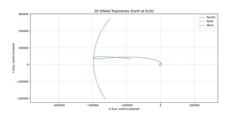

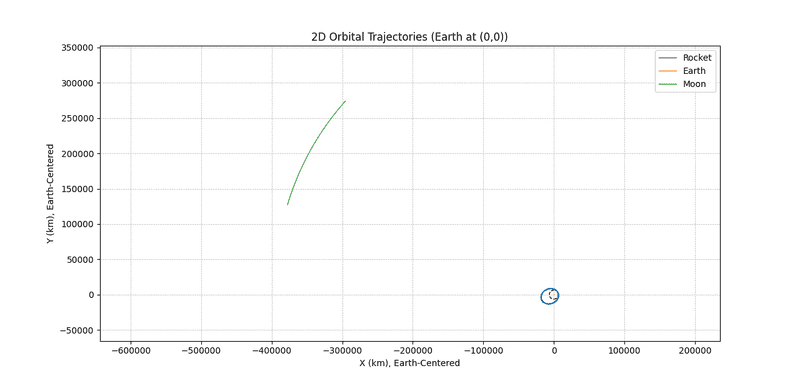

UlrickAKobbeltvedt
Hi everyone,
I'm working on a Python simulation that aims to replicate the Apollo 11 translunar injection (TLI) in a 3-dimensional geocentric system. My model includes Earth, the Moon, and a Saturn V–derived Apollo 11 rocket. The simulation starts at the moment of TLI, using initial positions and velocities obtained from NASA Horizons (Earth and Moon data from July 16, 1969, 16:16:16 UT) along with estimated state vectors for the rocket at low Earth orbit just before the injection burn.
My simulation details:
  • Dynamics: I model the gravitational forces between the bodies using Newton’s law and incorporate a thrust force during the TLI burn.
  • Burn specifics: The burn lasts 350 seconds using a J‑2 engine with a full thrust of 1.033×10⁶ N, a specific impulse (I_sp) of 421 s, and a calculated mass flow (≈250 kg/s). I also update the rocket’s mass during the burn.
  • Integration: I employ a 4th-order Runge-Kutta (RK4) method for integrating the equations of motion.
  • Data: The Earth and Moon initial positions/velocities are read from CSV files (with Horizons data), and the rocket’s starting state is estimated to be in the same reference frame.
The problem:Despite double-checking the input data and calculations for the gravitational forces, thrust, and mass changes, the simulated trajectory does not match the expected return orbit. Instead of achieving a proper return trajectory after the injection, the rocket’s path seems off.
My questions:
  1. Force Calculations: Are there any common pitfalls in computing the gravitational or thrust forces (e.g., unit conversion issues) that might lead to significant discrepancies?
  2. Integration Method: Could the RK4 implementation be a source of error in this context? Any suggestions for validating the integration accuracy?
  3. Thrust & Mass Update: Is the way I'm applying the thrust (with a fixed desired vector) and updating the mass during burn physically sound for this simulation?
  4. General Approach: Are there any aspects of the simulation setup (initial conditions, reference frame conversions, etc.) that could be problematic when trying to replicate the Apollo 11 TLI?
Below is my code(sorry for the Norwegian notes):

while current_time < simulation_time:
    current_time = rk4_step(bodies, dt, current_time)
    progress_bar.update(1)
    # Finn referanser til Rocket og Moon
    rocket_obj = next((b for b in bodies if b.name == "Rocket"), None)
    moon_obj   = next((b for b in bodies if b.name == "Moon"), None)
    # Etter at burn-perioden er over, utfør dumpen av den resterende S‑IVB-tørrmassen
    if current_time >= burn_start_time + burn_duration and not separation_done:
        if rocket_obj is not None:
            rocket_obj.mass = final_rocket_mass  # Sett rakettmassen til 45700 kg
            separation_done = True
    if rocket_obj is not None and moon_obj is not None:
        F_rm = gravitational_force(rocket_obj, moon_obj)
        F_rm_mag = np.linalg.norm(F_rm)  # i kg·km/s²
        rocket_speed = np.linalg.norm(rocket_obj.velocity)  # km/s
        distance = np.linalg.norm(rocket_obj.position - moon_obj.position)
        min_distance_list.append(distance)
        if distance < min_distance:
            min_distance = distance
            min_distance_time = current_time
        time_list.append(current_time)
        grav_force_list.append(F_rm_mag)
        rocket_speed_list.append(rocket_speed)
        mass_list.append(rocket_obj.mass)  # Logg rakettens masse
    for body in bodies:
        trajectories[body.name]["x"].append(body.position[0])
        trajectories[body.name]["y"].append(body.position[1])
        trajectories[body.name]["z"].append(body.position[2])
progress_bar.close()
print("Siste gravitasjonskraft mellom Rocket and Moon (kg·km/s²):", grav_force_list[-1])
print("Siste gravitasjonskraft i Newton:", grav_force_list[-1] * 1000)
print("Last velocity (km/s):", rocket_speed_list[-1])
print("minimal distance between Rocket and Moon (km):", min_distance)
print("Time of minimal distance (s):", min_distance_time)
def plot_trajectories(trajectories):
    # Plotter med Jorda i sentrum ved å subtrahere Jordas initielle posisjon
    earth_initial_x = trajectories["Earth"]["x"][0]
    earth_initial_y = trajectories["Earth"]["y"][0]
    fig, ax = plt.subplots(figsize=(10, 10))
    earth_radius_km = 6378
    circle = plt.Circle((0, 0), earth_radius_km, fill=False, color="black", linestyle="--")
    ax.add_patch(circle)
    for name, coords in trajectories.items():
        x_vals = np.array(coords["x"]) - earth_initial_x
        y_vals = np.array(coords["y"]) - earth_initial_y
        ax.plot(x_vals, y_vals, label=name, linewidth=1)
    ax.set_xlabel("X (km), Earth-Centered")
    ax.set_ylabel("Y (km), Earth-Centered")
    ax.set_title("2D Orbital Trajectories (Earth at (0,0))")
    ax.legend()
    ax.grid(True, which='both', linestyle='--', linewidth=0.5)
    all_x = []
    all_y = []
        all_x.extend(np.array(coords["x"]) - earth_initial_x)
        all_y.extend(np.array(coords["y"]) - earth_initial_y)
    margin = 1.1
    ax.set_xlim(margin * min(all_x), margin * max(all_x))
    ax.set_ylim(margin * min(all_y), margin * max(all_y))
    ax.set_aspect("equal", adjustable="datalim")
    plt.show()
  • Earth1969_results.csv
  • Luna1969_results.csv
Some quick comments:
  1. Yes, it is very easy to make conversion or unit errors in numerical work. Consider add self-test code that verifies the smaller parts against known solutions when possible. Don't fudge data with "emperical fitting factors" (like multiplying distances with 0.93) without knowing exactly why its needed.
  2. You can simulate without thrust and check that the rocket stays in predicted elliptical Earth orbit over many orbits, especially if Earth is set as the only gravitational body. What you want to look at is how much the orbital energy changes (in an ideal two-body problem, the orbital energy is constant).
  3. You can estimate the expected Earth orbit after TLI assuming impulsive maneuver and a delta-V from the rocket equation, and compare that with the actual orbit when you simulate the TLI burn. If they don't match well you may back off more and try simulate a linear burn without any gravitation and check how well you integrate a "pure rocket equation". Also check that your burn direction is indeed along the geocentric velocity or you will "waste" thrust due to gravitational losses.
  4. RK4 or better with good step size selection and/or control should be ok, but you may want to research a bit on symplectic integrators like the Verlet method.
Thanks for the help i found out the problem. It was the TLI boost, i changed it so the earths gravity bend the path of the TLI, and sorry that you thought i multiplied with 0.93, it was a remnant of an old comment, the coordinates that was in the code, is the legit ones. I also tweaked a little on the duration and engine thrust so it would have the right escape angle and speed to be caught in the return orbit around the moon. Allthough the TLI boost duration, and engine thrust isnt exactly the same as the apollo 11 mission i am pretty pleased with the results.
