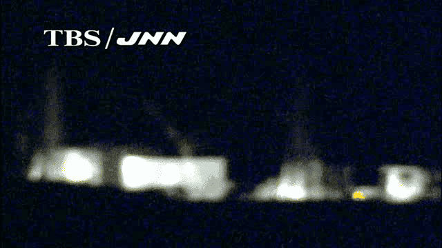

pdObq said:
Careful with these frames, they only show an integral over what happened within 1/25 s, faster dynamics will appear washed out.]
Also note that MPEG/JPEG encoding creates complicated artifacts. The shape of any detail that is smaller than 8x8 pixels is usually mangled beyond recognition. (If the detail persists unchanged over several frames you may recover some of the lost information by aligning and averaging, but that is not the case here.)
Moreover, color information is lost for objects that are too bright: the camera will just record white.
All you can tell from that pair of frames is that there was an orange or orange-white flash on the south side of the building, probably at the SE corner, about level with or above the service floor --- which is the location of the SFP. I believe it is not possible to extract further details of the flash shape and dynamics from that video.
As a general remark I totally agree, and there are indeed many very poor videos of these explosions, horribly re-compressed and color-releveled. The details we are looking at in this video is far, far larger than 8x8 pixels. A high quality HD source video was carefully selected for the exposee of the explosion at unit 3. While we should take care not to put too much trust in the images we see, we should also take care not to take them on as less trustworthy than they are.
True. However when we see a flash of fire first being almost white aka very bright, and the next frames show the flame turning through shades of yellow to red, we can be pretty sure that what we see, is the effect of decreasing temperature of the flame.
