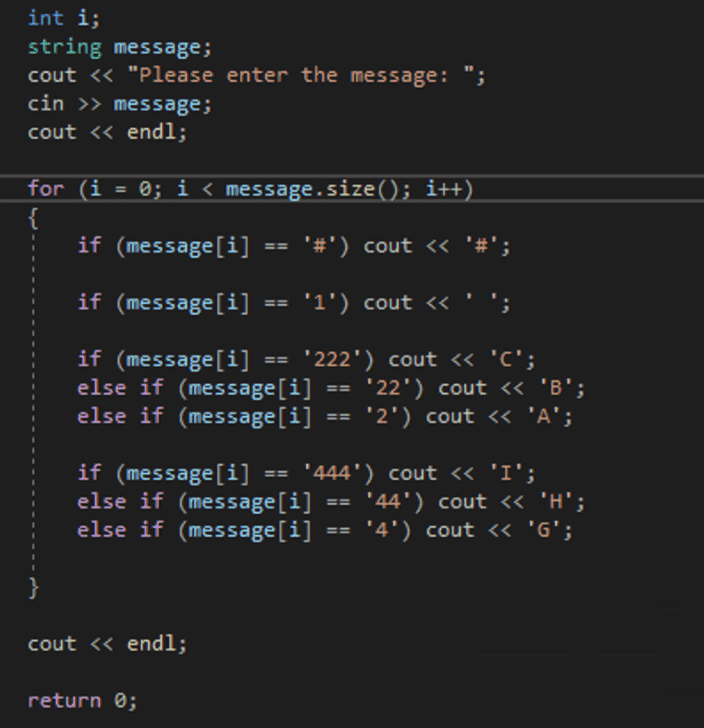

whysoserious2
Write a program to read a sequence of non-empty keystrokes and output the translated message and the number of characters typed. Note that the "space" should be counted as a character in the output.
Assume that the input message will not start with 0 and the length of the input message always consists of 17 digits.
Been trying to work this out for a while now but struggling to come up with a program that reads all of the samples. Based on the keypad, I should be receiving an "a" when I press "2" once. However, when I put in the code "222", I still get "a" instead of "c". I've attached the codes I put in and would appreciate any help I can get!

On line 17 you test whether the i'th character of the string is '222'. How many characters are there in '222'? How many characters are there in the i'th character of a string?
And similar problems on lines 18, 21, and 22.
To the OP: Instead of looking for sequences like 222, 22, 444, 44, etc. in that order, start from the first digit, and see if the next digit is the same, and if the third digit is also the same. You'll need a nested if else block for each digit 1 through 9.

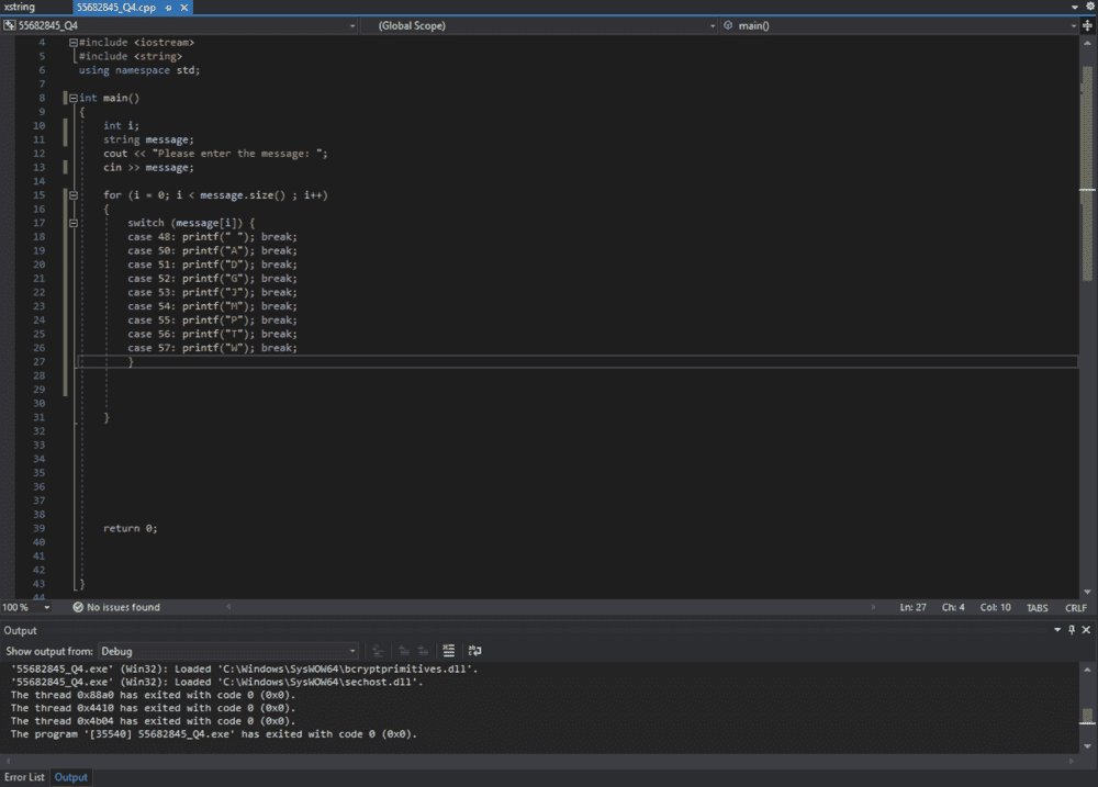

I tried to implement some of the new hints you all have given but am still having trouble. When I type in three "2's" I get three "A's" instead of a C.
That's because your code doesn't take into account that a digit can be repeated. Your code just looks at a digit in the string, and displays the first of the three characters for that digit. For the digits '2' through '6' and '8', your code needs to look two digits ahead to see if the current digit is by itself, or is followed by the same digit, or is followed by two more of the same digits. IOW, it needs to be able to handle, say, "2xy", "22x", and "222", where x and y are digits other than the current one at index i.
The code also needs to handle a "pause" digit, '1'. Your code currently doesn't handle '1' at all. So in addition to the above, it needs to handle "21" and "221".
Do you understand the purpose of the '1' digit?
The '7' and '9' digits are a bit more complicated, since each of these can represent four different characters.
In addition, if you post code, please post it as text rather than as a screen shot, and use code tags as in the following.

Here's my latest attempt. I managed to successfully get a "c" but is somehow having trouble with producing "b's" using the same logic. For example, when I enter "222", my output says "CB". When I enter "33322," I get FFCB.

You have several logic errors in your code.
C++:
for (i = 0; i < message.size(); i++)
          if (message[i] == '2')
              if ((message[i] = message[i + 1]) && (message[i + 1] = message[i + 2]))
                   printf("C");
          <snip>
In the nested if...else statements, you're not checking whether message[ i] happens to be equal to message[ i+1] -- you are actually assigning values to the variables on the left. You have the same logic errors in all of the nested if ... else statements.

I think you have learned it already -- use == instead of = in the comparisons. You used the correct operator in if (message[ i] == '2') and if (message[ i] == '3').
