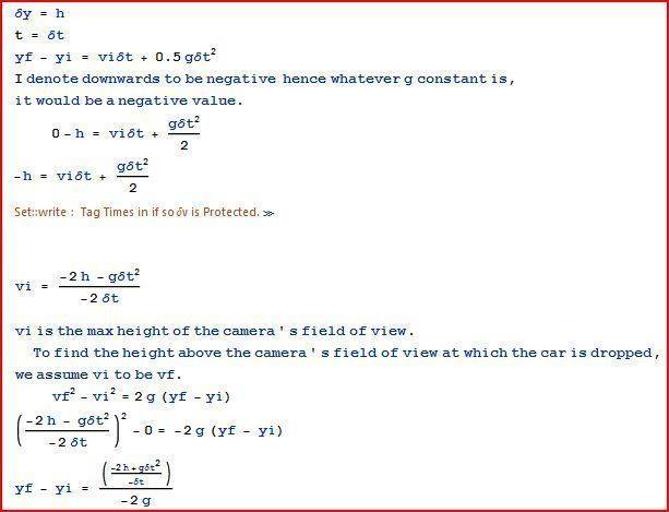

You're a consultant on a movie set and the producer wants a car to drop so that it crosses the camera's field of view in time Δt.
The field of view has height h.
Derive an expression for the height above the top of the field of view from which the car should be released.
None.
Handwritten-style algebra in Mathematica notebook output deriving an expression for the initial velocity vi from δy = h, t = δt, yf - yi = vi δt + 0.5 g δt^2, giving vi = (-2h + g δt^2)/(-δt), then yf - yi = ((-2h + g δt^2)/(-δt))^2 / (-2g) from vf^2 - vi^2 = 2g(yf - yi).
In going from the first to the second equation in the attachment below, there are sign errors and an error of a factor of 2 somewhere.
Otherwise, I think your work is ok.
[EDIT: I just noticed you are missing a square in your last equation of your post. Also, in your next to last equation it looks like you switched the sign of the right hand side. I find it a bit hard to keep track of your signs because of your sign convention of taking g to be a negative number.]

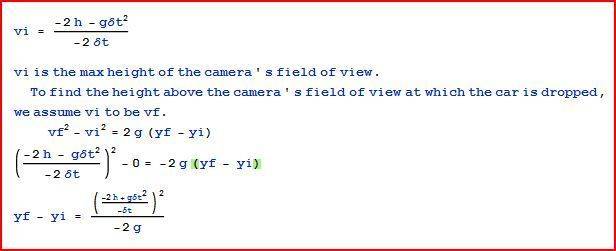

reattempting
  • Equation typeset as vi = (-2h - |g|δt^2) / (-2δt), a fraction with numerator -2h - |g|δt² over denominator -2δt.

You fixed the factor of 2, but you still have a sign error.
In the last equation? I forget to correct that. It should be -2h-2g(delta t)^2.

You still have a sign error in the equation below
  • Equation vi = (-2h - g·δt²) / (-2δt), with the numerator and denominator written as fractions in plain text.

You lost the exponent of 2 on the right hand side of the equation.

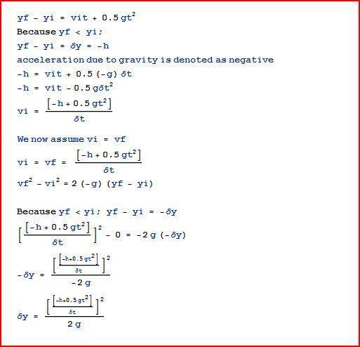

TSny said:
In the attachment below, note how you somehow added a negative sign on the right side of the equation in going from the first to the second equation.
Also, on the left side of the second equation, the denominator should not have a negative sign (assuming your convention that g is a negative number). This error won't matter here since you are squaring the entire quantity.
In your last equation, the denominator on the right side should not have a negative sign. This negative sign is the one you somehow added when going from the first to the second equation.
You can see how the overall signs don't agree for the left and right sides of the last equation. On the left side, you have yf - yi. So, the left hand side is overall negative because yf is less than yi. But the right hand side of your equation as written will give a positive quantity overall due to the error of the negative sign in the denominator.
Also, as you have already noted, the right hand side of the last equation still has a missing factor of 2 in the quantity inside the parentheses. (You have the factors of 2 correct in the next to last equation.)
Is this now valid?
Handwritten-style derivation in monospaced text: yf - yi = vit + 0.5gt^2, then with yf < yi and dy = -h, vi = [-h + 0.5gt^2]/dt, then vf^2 - vi^2 = 2(-g)(yf - yi), ending with dy = [(-h+0.5gt^2)/dt]^2 / 2g.
