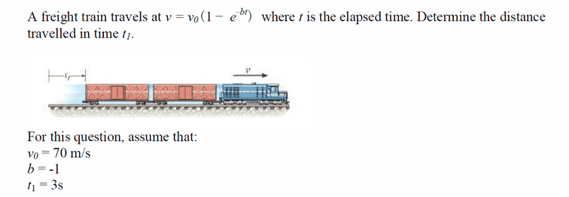

80
v = ds/dt
∫v dt = ∫ds
(put all inital values for V)
∫70-70e^t dt = ds
70t - 70t*e^t = s
There is something wrong with my methodology. can you guide me here?

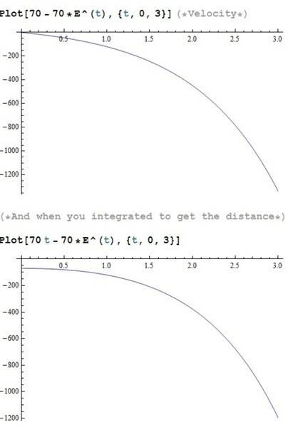

Well the function describes a train moving with a velocity that has a negative sign(if b=-1 see below). If they defined the positive direction to be the right direction. Then the function gives you a backwards moving train.
See the attached file,
The first graph is your given equation (velocity). The second graph is the distance which you found by integrating.
Examine the given equation(velocity) and you will notice that "b" is the constant which makes the velocity to be positive or negative. If b=1 then the train will travel in the positive direction and you will end up with positive distance.
