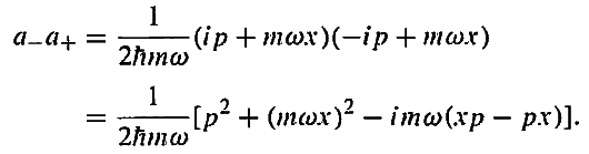

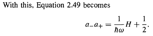

Hello, I was just watching a youtube video deriving the equation for the Hamiltonian for the harmonic oscillator, and I am also following Griffiths explanation. I just got stuck at a part here, and was wondering if I could get some help understanding the next step (both the video and book glanced over this part)
Video Link
The derivation starts at about 8:00
First defining
$$\hat {a}_{\pm} = \frac {1}{\sqrt{2 \hbar m \omega}}( \mp i \hat {p} + m \omega \hat {x})$$
$$ \hat {a}_{-} \hat {a}_{+} = \frac {1}{2 \hbar m \omega}(i \hat {p} + m \omega \hat {x})(-i \hat {p} + m \omega \hat {x}) $$
$$ = \frac {1}{2 \hbar m \omega}( \hat {p}^{2} + i m \omega \hat {p} \hat {x} - i m \omega \hat {x} \hat {p} + m^{2} \omega^{2} \hat {x}^{2}) $$
$$ = \frac {1}{2 \hbar m \omega}( \hat {p}^{2} - i m \omega (\hat {x} \hat {p} - \hat {p} \hat {x}) + m^{2} \omega^{2} \hat {x}^{2})$$
And I know the commutator ##[\hat {x}, \hat {p}] = i \hbar##
$$ = \frac {1}{2 \hbar m \omega}( \hat {p}^{2} - i m \omega ( i \hbar) + m^{2} \omega^{2} \hat {x}^{2} )$$
At this point both the video and Griffiths stop, although each do something different
I have no idea how Griffiths goes from this
To this
I will continue with what I was doing,
$$ = \frac {1}{2 \hbar m \omega}( \hat {p}^{2} + m \omega \hbar + m^{2} \omega^{2} \hat {x}^{2})$$
$$ = \frac {1}{2 \hbar m \omega}\hat {p}^{2} + \frac {1}{2 \hbar^{2} m^{2} \omega^{2}} + \frac {m \omega \hat {x}^{2}}{2 \hbar} $$
And from here I am not sure how both the video and Griffiths conclude
How do I get to the answer from my steps? Since I am not skipping..
=12(p̂ 2+(i)+m2ω2x̂ 2)
= \frac {1}{2 \hbar m \omega}( \hat {p}^{2} + m \omega ( i \hbar) + m^{2} \omega^{2} \hat {x}^{2})
There is an i too much in the term in the middle
Maylis said:
=12mωp̂ 2+122m2ω2+mωx̂ 22
The term in the middle is again wrong...
Basically the last two equations you wrote before the Griffiths insert are wrong.
Once you have them right, you know that the Hamiltonian is
H=\dfrac{p^2}{2 m} + \dfrac{1}{2} m \omega^2 x^2
Likes gfd43tg
Woops, I caught my error and now I am able to see how it was done. Thanks.
