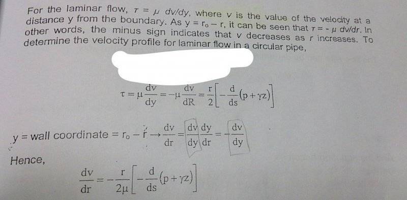

why when we are considering the velocity as a function of the distance from the the wall , it's positive ? or we can also consider the distance from the wall as positive ?mfig said:The negative sign is included because you are considering the velocity as a function of the distance from the center line of the pipe, not from the wall.
can we consider the distance from the centerline of pipe to wall as positive ?mfig said:The negative sign is included because you are considering the velocity as a function of the distance from the center line of the pipe, not from the wall.
