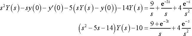

Differential equation y'' - 5y' - 14y = 9 + u_3(t) + 4(t - 1)u_1(t), with initial conditions y(0) = 0 and y'(0) = 10.
Taking the transform:
Two equations in s and Y(s) for a Laplace transform: s^2 Y(s) - sy(0) - y'(0) - 5(sY(s) - y(0)) - 14Y(s) = 9/s + e^(-3s)/s + 4e^(-5s)/s^2, and (s^2 - 5s - 14)Y(s) - 10 = (9 + e^(-3s))/s + 4e^(-5s)/s^2.
Just wondering, can someone explain to me why the e-3s/s is positive, and not negative because it is originally -u3(t)...

Initial value problem: y'' - 5y' - 14y = 9 + u_3(t) + 4(t - 1)u_1(t), with y(0) = 0 and y'(0) = 10, where u_c(t) denotes the Heaviside step function.
Two Laplace-transformed equations in Y(s): s^2Y(s) - sy(0) - y'(0) - 5(sY(s) - y(0)) - 14Y(s) = 9/s + e^(-3s)/s + 4e^(-5s)/s^2, and (s^2 - 5s - 14)Y(s) - 10 = (9 + e^(-3s))/s + 4e^(-5s)/s^2.
It's probably just a typo in the original problem.

  • Two Laplace-transformed equations in Y(s): s^2Y(s) - sy(0) - y'(0) - 5(sY(s) - y(0)) - 14Y(s) = 9/s + e^(-3s)/s + 4e^(-5s)/s^2, and (s^2 - 5s - 14)Y(s) - 10 = (9 + e^(-3s))/s + 4e^(-5s)/s^2.
