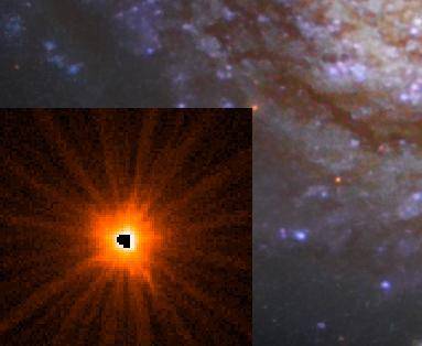

Those telescopes are far away from the theoretical resolution based on the wavelength. See the images of a point-like x-ray source with XMM Newton, for example. Their sides are 110 arcseconds (~2 arcminutes) long. As comparison, Wikipedia has an image of Messier 100 with a ground-based 1.5m telescope. The whole galaxy is just 7x6 arcminutes wide.
I copied both images together, they have nearly the right size per pixel. The resolution difference is huge, and the ground-based telescope is small compared to the biggest telescopes we have. The planned E-ELT will have a resolution better than the pixels in this image.
