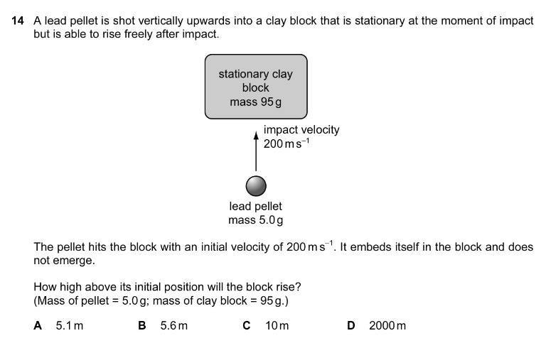

Lead pellet shot vertically into a clay block

PCM ∑pi=∑pf
v2=u2+2as
First, using the PCM equation, I found the final velocity of the block, which is about 10.5 ms-1.
Then by using the SUVAT formula, i would be able to find the distance moved by the block, but I don't have time nor acceleration. Any hints?

How do you figure this? Won't the block with the embedded bullet rise until gravity causes it to fall back to earth?

Not quite right. The bullet stays in the clay.

I assume Janice meant final in the sense of 'at the end of the impact phase'.

During impact, certainly, which is why Janice did not use conservation of energy to get the 10.5 m/s.

Oh...so the mass of the block would now be 100g ? Ok, now I get v=10m/s exactly.
And by using v2=u2+2as, I'm able to get the answer which is 5.1m, but why do we assume that the acceleration of the block is g?

I mean, I can't imagine this situation.. How does the clay block stays stationary in air without any "support" ?
Before the impact? It only says it is stationary at the moment of impact. Maybe it was thrown up in the air and the bullet struck it at the highest point. It really doesn't matter how it came to be.
The block plus bullet are now in free fall.
I see I see, ok thank you !
