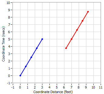

Here is a spacetime diagram depicting two objects separated by 5 feet that are stationary in a frame:
The dots represent 1-nanosecond ticks of time for the two objects. We call these events. Now we can transform the coordinates of all these events using the Lorentz Transformation to a frame in which the two objects are traveling at 60% of the speed of light. The speed of light is 1 foot per nsec:
You can see that the distance between the two objects is 4 feet. If you look at the last event for the blue object at the Coordinate Time of 5 nsecs, you will see that at that same time, the Coordinate Distance to the red object is 4 feet (from 3 feet to 7 feet). That is what Length Contraction is--their separation or distance according to one frame where the objects are moving compared to their separation or distance according to the frame in which they are at rest.

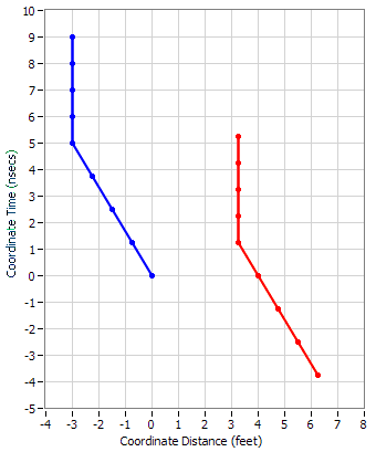

But you asked what happens between two that start moving. Here is a spacetime diagram to show one such example of that where they both start moving at 60%c according to their original rest frame:
As you can see, their separation remains the same, 5 feet. But if we transform to the frame in which they end up at rest, we see that their separation expands:
But if you remember our definition of Length Contraction, it is their separation in the frame in which they are in motion, the second diagram up, compared to the frame in which they are at rest, the one immediately above and we see that it is 5 compared to 6.25 which has the ratio of 0.8, the same ratio before when we compared 4 feet to 5 feet.
