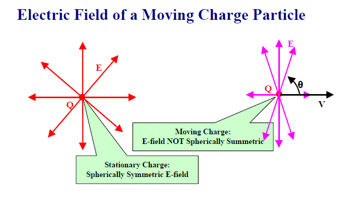

OK - for the second question. I'm going to cheat and give the answer for electromagnetism, because the notion of an electromagnetic force is better defined than the notion of a gravitational force, and because the math is easier.
If andromeda was charged, and you measured the electric field (by measuring the relative acceleration between a charged and noncharged particle, for instance), and the moving observer also measured the electric field in a similar manner, you'd both get the same answer if the moving observer was headed directly towards andromeda.
The math looks like this (from wiki)
where the subscripts indicate fields parallel and transverse to the direciton of motion, repsectively.
If you sketched out the electric field from Andromeda, and compared it from relatively stationary and relatively moving points of view, you'd get something like:

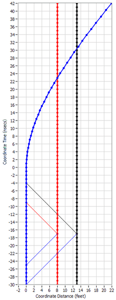

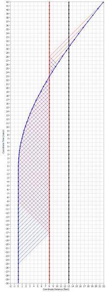

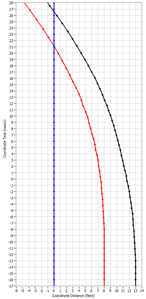

Let me change your scenario a little bit to make it easier for me to illustrate with some spacetime diagrams. Let's say you are at rest with a five-foot long rod with the near end 8 feet in front of you and the far end 13 feet in front of you. After a while, you start accelerating toward the rod and by the time you reach it, you are going about 0.6c.
This analysis is going to be based on your taking measurements with a pair of laser range finders, one aimed at the near end of the rod and one aimed at a reflector mounted on the far end of the rod. A laser range finder works by sending out a pulse of light and measuring how long it takes for the light to reflect back to it. It then divides that time by 2 and multiplies by the speed of light to display the distance. By making two measurements, you can determine the length of the rod. For convenience sake, I'm going to define the speed of light to be 1 foot per nanosecond.
While you are still at rest with the rod, it doesn't matter when you make the measurements to the near and far ends of the rod because you'll always get the same answer. But when you are moving, in order to get consistently meaningful results, you have to make both measurements at the "same time". Einstein's way of doing this is to assume that the laser light takes the same amount of time to get to the target as it takes for the reflection to get back to your laser range finder. In practice, the laser beams would have to carry a coded signal so that the time of emission can be correlated with the time of reception in order to identify a "time of the measurement" half way between them. We have to imagine that each laser range finder (or equipment that is hooked up to them) keeps track of all those times and then later, you, or your equipment can create the spacetime diagram that I'm about to show you.
Here's the first diagram showing your path in blue, the near end of the rod in red and the far end of the rod in black:
You're going to start your acceleration at your time zero but long before that, you are going to start to make your measurements and continue doing the same thing throughout the scenario. I have shown a pair of these measurements to illustrate how you determine that the rod is 5 feet long.
Remember, your laser range finders are constantly sending out coded light pulses and getting their reflections some time later and logging them. You can't do the calculations while it is actually happening. After your trip is done, you look at the logs of one laser range finder for a sent/received pair whose average time matches the average time for a sent/received pair on the other laser range finder. The above diagram shows one such matched set. The first laser range finder sent a laser signal at your time of -25 nsecs and received the reflection at -9 nsecs for an average time of -17 nsecs. The other laser range finder sent out a signal at -30 nsecs and received its reflection at -4 nsecs for the same -17 nsec average. Once you have selected a matched set of timings between the two laser range finders, you next calculate the distance that each one measures. You do this by taking the difference between the logged readings for one of the devices, divide by two and multiply by the speed of light. So for the near device, you take 25-9=16 and divide that by 2 to get 8 nsec and since light travels at 1 foot per nsec, this comes out to be 8 feet. Doing the same thing for the far device gives us 13 feet. Thus we have measured the length of the rod to be 13-8=5 feet. Once you understand this principle, you can follow the rest of this process.
I have uploaded some more diagrams and text files to show how the determination is made for both devices. (The dashed line in the text files marks the point where you pass one end of the rod and have to send your signals the other way.) You can click on the thumbnails and files at the bottom of this post if you are interested in seeing the details but here is the final result of how you establish the length of the rod as it approaches and passes you. This, by the way, is known as the radar method and is just one of many legitimate ways of creating a non-inertial rest frame for an accelerating observer:
You will note that the rod starts contracting before the time of your acceleration (0 nsecs) and that it happens differently for both ends of the rod. Make sure you understand that you measure the length horizontally, for example, along one of the horizontal axis lines. You can think of these as lines of simultaneity.
Note also that when the leading edge of the rod reaches you, even though its speed is about 0.6c, the rod has already contracted to less than 80% of its original length. Other ways of establishing a non-inertial frame would make this happen at the point of contact with the rod.
Does this make sense to you. Any questions?
