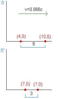

Hi,
Suppose a stationary frame S' is observing frame S moving with velocity v=0.866c in the x-direction, and let points (4,0),(10,0) define the ends of a rod in S, so its distance is 6, but as measured from S' contracts to 3 because of the Lorentz factor gamma.
I'm unable to determine what the rod coordinates (?,0),(?,0) are in frame S'.
Perhaps S' would say the rod endpoints (4,0),(10,0) do exist in S, but the distance is really 3?
Thanks for your time! ;)
That's the right answer ;-)
From the information given, you are unable to determine the coordinates in S'. You'd have to decide what coordinates to give one event, such as the event of one end of the rod being at x=4 according to S. A simple choice would be to call this event x'=4, t'=0. Another would be to call this event x'=0, t'=0. But really it's up to you. Once you've made that arbitrary choice, you can determine the x' coordinate (space coordinate in S') of the other end of the rod at t'=0. In this case, you already know that it's 3 + whatever space coordinate in S' you decided to give to the event which S calls x=4, t=0. So if you called it x'=4, the other end would be at x'=7.

Can S' correctly assert that the rod endpoints 4,10 exist somewhere in spacetime,
but the rod length is 3 not 6?
Thanks.
Yes, that's one way of putting it: if the left end of the rod is at x'=4 at some value of t', then the right end will be at x'=10 at some other, different value of t'.

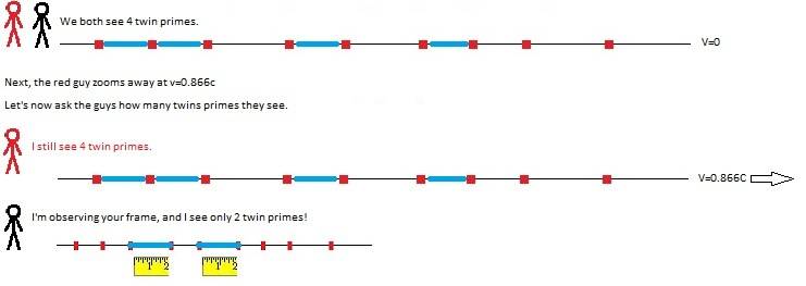

My main inquiry is if there exists any link between special relativity and the twin prime conjecture. I was attempting to determine if there's an infinite number of twin primes (p, p+2) by somehow relating that to the Lorentz factor contraction.
For example, consider these primes (3,7) in S moving at v=0.866c.
Frame S' agrees these are primes separated by 2 instead of 4.
So, S' observes what it thinks is a twin prime.
By adjusting the frame S velocity an infinite number of times,
is it possible that S' observes an infinite number of relativistic twin primes?
I know...crazy me. :redface:
I've never studied physics, but am curious about these things.
Your responses indicate you've studied special relativity quite well.
Thanks!

Is the guy that sees only 2 twin primes correct?
Thanks.
Black can find just as many twin primes labelled along his own (Black's) coordinate line as Red can find on Red's coordinate line. But if an event is labelled, say, with the x coordinate 2 in Red's coordinates (Red's "rest frame"), it won't necessarily be labelled with the x coordinate 2 in Black's rest frame. Where the relative speed difference between Black and Red is 0.866 c, if a pair of objects are not moving relative to Red, and Red measures them to be 2 units apart, Black will measure them to be 1 unit apart. Likewise if a pair of objects are not moving relative to Black, and Black measures them to be 2 units apart, Red will measure a distance between them of 1 unit. Their different coordinate systems are just different ways of associating real numbers with events in spacetime.
Their coordinates differ by a particular kind of coordinate transformation called a boost, the kind of Lorentz transformation that results from chosing a new arbitrary standard of zero velocity. Changing from one coordinate system to another doesn't change the intrinsic properties of spacetime, nor does it change the intrinsic properties of the real numbers, such as the amount of prime numbers or their spacing. It just changes a parameter in the rule whereby numbers are paired with events, so that different numbers are paired with different events.
