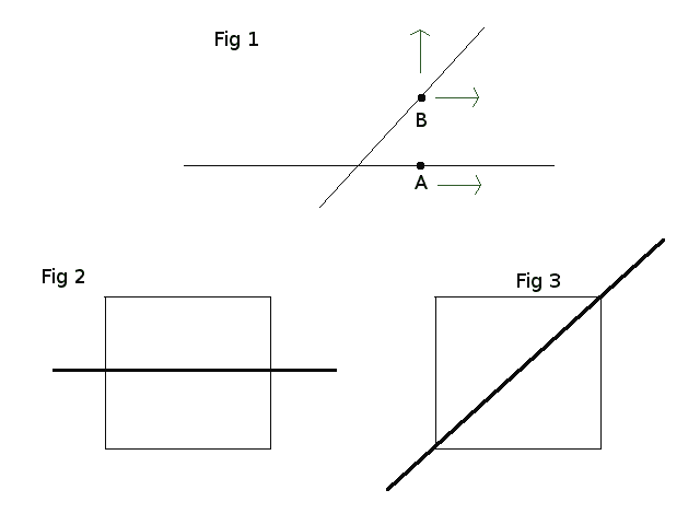

Object A goes horizontal line and object B diagonal line in 45 degrees angle (Fig 1). A and B have the same velocity ##v## in x-direction. In y-direction, B has velocity ##v##, A has none. The magnitude of ##v## is not very important, but the total speed of B must be below ##c##.
In their own rest frames, A and B are square-shaped and of same size. In A's rest frame (Fig 2), horizontal line is moving through A from right to left. In B's rest frame (Fig 3), diagonal line is moving through B from top-right corner to bottom-left corner.

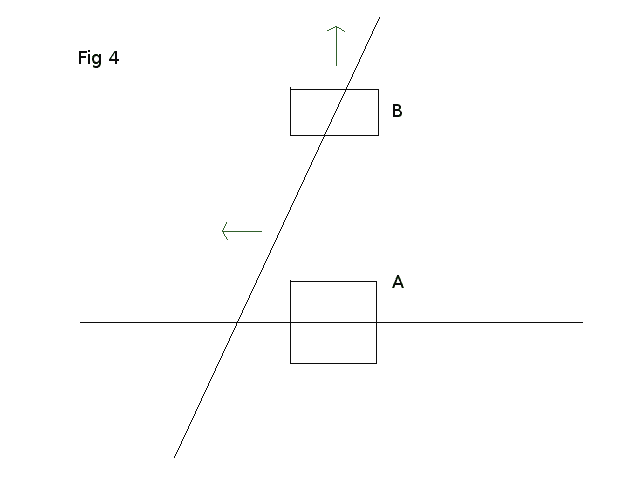

The problem (Fig 4). We are in A's rest frame. I think the following three conditions must be met:
- B is length contracted in y-direction, but has its proper length in x-direction, because B is moving up with some velocity and there is no velocity in x-direction
- Diagonal line's angle is more than 45 degrees, due to length contraction, because the line itself is moving to left.
- Diagonal line must go through B so that it goes from top-right corner to bottom-left corner, as it does in B's rest frame, because it's absolute which parts of B meet with diagonal line and which not.
Putting these three together, I don't see how they all could be true. B is too shallow to give the diagonal line the room it needs.
There is no math yet, but before going into that, I'd like some comments if anyone finds this interesting and worth further effort. Of course if you see this is based on a simple mistake, please point that out, so I don't have to struggle with my misunderstandings anymore. Thanks.

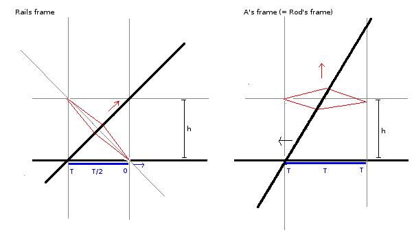

About the discussion in #15 and #16, here is my understanding of the scenario. This quick picture is not accurate in all things, but it's indended to show the following:
- In rails frame (left) A and B are length contracted in direction of motion. A is contracted in x-direction, B is somewhat "diamond shaped" due to contraction in direction of diagonal rail (as it was already drawn in previous posts). As a curiosity, because B conracts diagonally, it retains (at least in some sense) its original dimensions in x- and y-direction. A doesn't do that, but it contracts in x-direction and retains its height in y-direction.
- In B's frame (right) the diagonal rail is at 45 degrees angle relative to B, but the angle between the rails is larger due to length contraction in diagonal direction. The middle grey line represents what the direction of horizontal line would be, if the rails weren't moving, but they are. I'm not sure of A's shape in this frame (it could be skewed) but it seems to me that the horizontal rail must go through A as described in Fig 2 of #1. It's absolute which parts of A and B meet the rails and which do not. A surely has downward velocity in this frame, but it may or may not have velocity in x-direction.
I agree. Qualitatively your sketch seems reasonable with that caveat.

The rotation issue is very interesting. A and B could start from the same rest frame, with same orientation, and accelerate in their desired direction of motion (horizontal and 45 degrees) so that they retain their original shape in their own rest frames. To achieve that, both must accelerate so that the rear (looked relative to direction of motion) accelerates first, middle parts then and nose last. But the acceleration vector most definitely looks the same for each part of the object, so where could the rotation come from? Is this rotation something we could measure by gyroscope? If not, what is happening?
I'm starting to get an idea of what B's shape in A's frame might be, but only quantitatively. I'd like to do this with numbers, but that must wait, it's harder than it sounds... Anyway, here is a picture where we imagine a measuring rod (blue in the picture) moving left along the horizontal rail (i.e. in A's frame), with x-velocity, position and contracted length that match B.
The rod's clocks are synced in its own frame, so in the rails frame, rear is ahead compared to nose. T, T/2 and 0 are times in rod's clocks. When we jump into rod's frame, when the rear of the rod is at the crossing of rails, we see rod longer than it was and all clocks show T.
Now, omitting quite a few details I would say that due to relativity of simultaneity, the parts of B (when looked in rod's frame) have moved upwards: the more right they are in x-position, the more they have moved up in y-position compared to the situation in rails frame. As a result, B is still diamond-shaped and somewhat skewed, but more horizontal position than it was in the rails frame. This is not to say that B retains its original shape and just rotates - most likely it will also change its shape. But the diagonal rail just might be able to go from corner to corner as it's supposed to. This is just an initial study, but I'm posting this anyway in case anyone finds these ideas useful.
