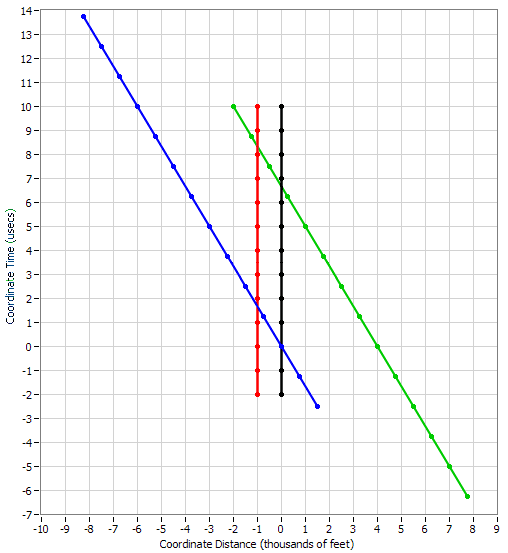

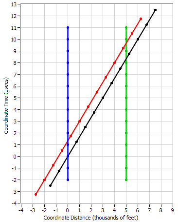

Here is a spacetime diagram depicting the rest frame of A (blue) & B (green) separated by a distance of 5000 feet in which the spaceship (red and black) is traveling at 0.6c. The dots mark of one-microsecond increments of time. The speed of light is 1000 feet per microsecond:
Note that the length of the spaceship is contracted from its Proper Length of 1000 feet to 800 feet and its tick marks are dilated to 1.25 microseconds.
Transforming to the rest frame of the spaceship, we get:
Note that the distance between A & B is contracted to 800 feet and their times are dilated to 1.25 microseconds while the spaceship's length is 1000 feet and its clocks are normal.
So in either case, we normally only focus on one effect to explain what's going on: in the A/B rest frame, we focus on the spaceship's clocks being Time Dilated (even though the spaceship is also Length Contracted) and in the ship's rest frame we focus on the distance between A & B being contracted (even though its clocks are time dilated).

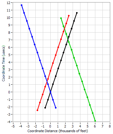

But just to assure you that the two effects are not mutually exclusive, we can transform to the frame in which A & B are traveling at 0.3333c in one direction while the spaceship is traveling at the same speed in the opposite direction:
Here we see that both A & B and the spaceship are Length Contracted to the same extent and their clocks Time Dilated equally.

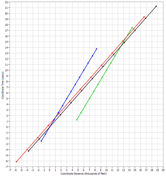

I've uploaded some more spacetime diagrams at additional speeds to show different patterns of Time Dilation and Length Contraction. Remember, there are no preferred frames in Special Relativity, not even an object's own rest frame. Any frame is just as valid as any other frame.
Does this make perfect sense to you? Any questions?
