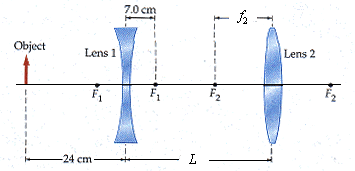

Here is the problem I am working on:
Two lenses that are L = 38 cm apart are used to form an image, as shown in Figure 26-52. Lens 1 is diverging and has a focal length f1 = -7 cm; lens 2 is converging and has a focal length f2 = 16 cm.
[a] Determine the distance from lens 1 to the final image. (Include the sign of each answer.)
What is the magnification of this image?
I got [a] correct with an answer of 62.3003 cm, using di1 = (1/f1 - 1/do1)^-1. For part I did the following:
m = (m1)(m2) - (-do/do1)(-di2/do2) = (di1)(di2)/(do1)(0.38m-di1) = -0.188, which is wrong. Anyone able to help me out? Thanks.
Not clear what you did wrong. What did you get for di1, do2, di2? And thus m1 and m2?

di1 = -8.8421 cm
do2 = (38cm - di1)
di2 = 24.3003 cm
m1 = -do/do1
m2 = -di2/do2
I used my values for di1 and di2 for part [a] and got the answer right, so I'm sure at least those 2 are correct. I am pretty sure the rest are as well, but let me know if it is an error in any of these values that is giving me a wrong answer.

I get a different value for di1 (and thus di2 and part [a]), so one of us is making an error.

And of course Doc Al is right. Your di1 is not correct; that error propegates through your calculation. Also, although your final expression for the magnification is correct there are some (probably just typographical) errors in the intermediate steps. As a check on your yourself it would be good to keep in mind that the virtual image of a diverging lens is between the lens and the focal point. Your di1 is not.

Using di1 = (1/f1 - 1/do1)^-1 = (1/-14cm - 1/24cm)^-1, I still get the same answer of -8.8421 cm.
Where did that 14 cm come from?
Double the 7cm, still keeping the negative sign. Is that incorrect? Am I supposed to just use -7cm instead of -14cm?
Why in the world would you double it? The focal length is given as 7 cm, so use -7 cm (negative since it's a diverging lens).

Oh, my mistake lol. So the real answer for [a] is 63.3365 cm?, and di1 = -8.4194 cm and di2 = 25.3365 cm?
So my answer for should be -0.2028?
Please correct that value of di1, once and for all. (Yes, part [a] looks OK.)
LOL okay. And is my part correct as well? Whoops, I meant, 0.1244 as my answer for .

m = (m1)(m2) - (-do/do1)(-di2/do2) = (di1)(di2)/(do1)(0.38m-di1) = -0.1312 (sorry, this is my final answer lol)
di1 = -0.054 m
di2 = 0.253 m
do1 = 0.24
do2 = 0.38 m + 0.054 m
Much better. (Whew! :tongue: )
