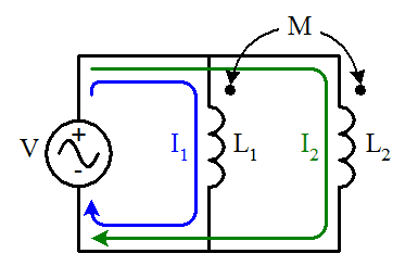

Hi, I'm a bit stuck on part d).
I am struggling to see how others have achieved 0.75L for Leq.
So far i have used the Leq equation and simplified down to Leq = L2 - (0.5L)2 / L
I can't seem to get 0.75 from this, any help would be appreciated.

  • #63
Yes sure.
M = k√L1L2
L1=L2
M = k√L2
M = kL
k = 0.5 therefore M = 0.5L
Substituting into: Leq = (L1L2 - M2) / (L1+L2 - 2M)
Leq = L1L2 - (0.5L)2 / L1+L2 - 2(0.5L)
Where L1=L2=L
Leq = L2 - (0.5L)2 / L + L - L
= L2 - (0.5L)2/ L

How did the numerator and denominator end up being broken into separate terms? By convention what you've written is parsed as:
##L_{eq} = L_1 L_2 - \frac{(0.5 L)^2}{L1} + L2 - 2(0.5 L)##
You need to make more use of parentheses to keep the terms grouped and make the implied order of operations clear.
Try again being sure to keep the numerator and denominator terms of the original equation together.

Apologies for that gneill, i'll try again.
##L_{eq} = \frac{L_1 L_2 - (0.5L)^2}{L_1 + L_2 - 2 (0.5L)}##
##L_{eq} = \frac{L^2 - (0.5L)^2}{L + L - L}##
##L_{eq} = \frac{L^2 - (0.5L)^2}{L}##
Hopefully that makes for better reading.
  • #66
Much better. Can you continue to simplify the equation? Hint: Let 0.5L be L/2.
  • #67
##L_{eq} = \frac{L^2 - 0.25L^2}{L}##
  • #68
Okay, continue.
  • #69
gneill said:
Okay, continue.
Would i then divide the L, leaving:
##L_{eq} = L - 0.25L##
No idea why I'm struggling with this!
  • #70
You just need to practice your algebra.
Continue. Factor out the L on the right hand side.
  • #71
The penny has dropped, L minus 0.25xL leaves three quarters of an L!
i.e. 0.75L
Thank you gneill.

Hi all,
I'm new to writing on the forum but hopefully get this presented right.
Here's my problem b) - obtaining the current ratio I1/I2.
Here is where I am:
First of I have the equations from question A)
ABEF : V= jw*L1*I1+jw*M*I2
ABCDEF : V=jw*L2*I2+jw*M*I1
Now on to question B)
V=V
jw*L1*I1+jw*M*I2 = jw*L2*I2+jw*M*I1
Factorise jw
jw(L1*I1+M*I2) = jw(L2*I2+M*I1)
Divide by JW
L1*I1+M*I2 = L2*I2+M*I1
let V/jw = E
Eq (1) E = L1*I1+M*I2
Eq (2) E = L2*I2+M*I1
find I1 and I2
Divide by L1-M*I2
E/L1-MI2 = I1
Substitute into Eq2
Eq (2) E = L2*I2+M(E/L1-MI2)
remove the brackets
E = L2*I2+ME/L1-MI2
Divide by I2 and multiply by E
I2 = E*L2+ME/L1-M
Substituting I1 and I2 back into Eq 2
E = L1(E/(L1-M(E*L2+ME/L1-M))) + M (E*L2 + ME/L1-M)
this is why I think I've got this wrong! :cry: after day 3 of head scratching.
Many thanks in advance

Your algebra does not look correct. Can you show more detail in the steps you took? You said, "dividing by I2 and I1", but I don't see how you could arrive at:
(L1+M)/I1 = (L2+M)/I2
  • #79
It doesn't work :sorry:...
Try again, sorry
  • #80
Ok so here's were I am and I'm lostL1*I1+M*I2 = L2*I2+M*I1
Dividing by L2
(L1*I1+M*I2)/L2 = I2+M*I1
Divide L1
(I1+M*I2)/L2 = (I2+M*I1)/L1
Subtract M
(I1+I2)/L2 = (I2+I1)/L1
  • #81
You should do as I previously suggested and first gather all the "like" current terms together. So move all the I1 terms to the left hand side and all the I2 terms to the right hand side. I think that'll clear your path.
  • #82
Got it!
(L1*I1)+(M*I2) = (L2*I2)+(M*I1)
Subtract (M*I1)
(L1*I1)+(M*I2)-(M*I1) = (L2*I2)+(M*I1)-(M*I1)
Factorize
I1(L1-M)+(M*I2) = (L2*I2)
Subtract (M*I2)
I1(L1-M)+(M*I2)-(M*I2) = (L2*I2)-(M*I2)
Factorize
I1(L1-M) = I2(L2-M)
Divide by I2
(I1(L1-M))/I2 = (L2-M)
Divide by (L1-M)
L1/L2 = (L2-M)/(L1-M)

  • #83
Hi gneill,
I'm looking at c now - showing that L1 and L2 can be replaced by the equivalent inductor.
Following on from previous advise let
E=L1*I1+M*I2 (eq 1)
E=L2*I2+M*I1 (eq 2)
I'll broken down eq 1 as an example.
E=L1*I1+M*I2
Subtract (M-I2)
E-(M*I2) = L1*I1+M*I2 -(M*I2)
Divide by L1
E-(M*I2)/L1 = L1*I1/(L1)
E-(M*I2)/L1 = I1
Likewise for I2 I end up with
E-(M*I1)/L2 = I2
I then substituted these values back to form a simultaneous equation using my answer from A) and get
V=jw*L1*(E-(M*I2)/L1)+jw*M*(E-(M*I1)/L2)
V=jw*L2*(E-(M*I1)/L2)+jw*M*(E-(M*I2)/L1)I'm I right so far?
  • #84
It looks okay. You should be sure to use parentheses to ensure that there is no ambiguity in the order of operations. Thus:
(E-(M*I2))/L1 = I1 ##~~~~##-and-##~~~~## (E-(M*I1))/L2 = I2
Treat these as two equations in two unknowns and solve for I1 and I2 (The expression for I1 should not contain I2, and similarly the expression for I2 should not contain I1).
As a suggestion, you won't have to return to the part A result if you define the equivalent inductance to be
V = jω Leq(I1 + I2)
or in terms of your E:
E = Leq(I1 + I2)
Use your "solved" expressions for I1 and I2 from above to proceed.

Hello gneill,
I have tried to follow your instruction above for part c) and was wondering if I'm on the right lines?
We have the Kirchoff's loop equations from part a) right? i.e.
##V=(jwL_{1}I_1{})+(jwMI_{2})##
##V=(jwL_{2}I_2{})+(jwMI_{1})##
So transposing for I, I get:
##\frac {V-(jwMI_{2})} {jwL_{1}} =I_{1}##
##\frac {V-(jwMI_{1})} {jwL_{2}} =I_{2}##
Cancelling jw and filling in the formula you gave:
##\frac{V}{jωL_{eq}} = I_1 + I_2##
##\frac{V}{jωL_{eq}} = \frac {V-(MI_{2})} {L_{1}} + \frac {V-(MI_{1})} {L_{2}}##
Feel like I've gone very wrong somewhere!
Thanks
  • #88
Hi Triopas.
What you have is three equations to work with, one being the definition introduced for ##L_{eq}##, and the other two being the expressions obtained from your KVL. I'd suggest first making the substitution:
##U = \frac{V}{j ω}##
in your three equations so that you can work without complex values. The three equations become:
##U = L_{eq}(I_1 + I_2)##
##U = L_1 I_1 + M I_2##
##U = L_2 I_2 + M I_1##
Start by solving the last two equations for ##I_1## and ##I_2## in terms of U, L's and M. There should be no ##I##'s in the solutions, just U, L's, and M.
