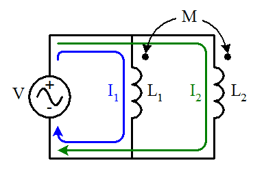

I am suffering on (c).
I need to find I which is I1+I2
Therefore I need to find I1 and I2
From (b) working backwards by one step.
i1 (L1-m) = i2(L2-m)
Therefore:
i1 = (i2 (L2-m))/ (L1-m)
i2 = (i1 (L1-m))/ (L2-m)
Adding them together I still have two values for I
If I use substitution
I end up with.
i1(L1-m)(L2-m) = i1 (L1-m)(L2-m)
Which I is true, but not at all helpful!
How on Earth do I start this question!

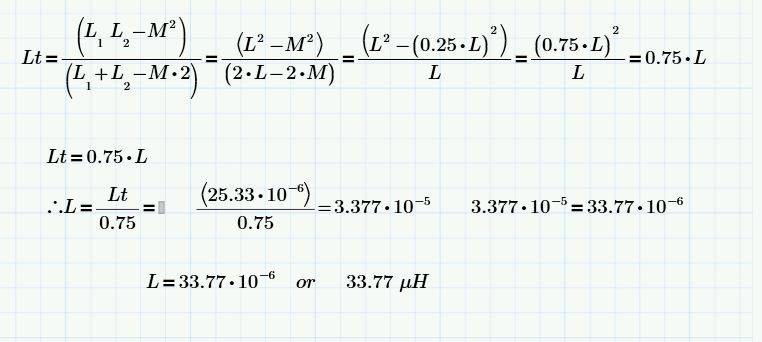

Ok so far I have a few values, I have tried following some of the earlier instructions but I'm stuck for part (d)
As everyone L=1/((2pif)^2)C
L=25.33 microhenrys
M=k sqrt L1L2
Or M=kL
K=0.5
M=0.5L
With rearranging
Leq = (L^2 - m^2)/(2L -2m)
Replace m with kL
Leq=(L^2-0.5L^2)/(2L-(2x0.5L)
Leq=(L^2-0.5L^2)/L
Leq=(L-0.5L)
Leq=0.5L
Leq=25.33 microhenrys
25.33 microhenrys = 0.5L
L=50.66 micro-henrys
is this right or have I done it wrong?

Yeah I have tried using the equations from a), but am struggling with solving them simultaneously.
V=jw*L1*I1+jw*M*I2
V=jw*L2*I2+jw*M*I1
I have input it into my calculator to solve for I1 and I2 and get the correct answers. I can't get the same answer in Wolfram. I would really like to know how to solve these two for I1 and I2 without using my calculator. Any more help would be hugely appreciated. Maybe just the first step to solving, to get the ball rolling?

I don't think that's the correct answer, I think its around 33. I have it worked out at home on paper, I will have to check tomorrow unless somebody else beats me to it.

M is 0.5L, but you've replaced M2 with 0.5 L2. The 0.5 should not have escaped the squaring!
V=jw*L1*I1+jw*M*I2
V=jw*L2*I2+jw*M*I1
This is basic simultaneous equations.
Rearrange the first equation so you have I1 = <stuff>.
Substitute that <stuff> into the second equation where I1 appears. Solve for I2. Use this result to replace I2 in the <stuff> in order to obtain a value for I1.

Can you tell me why, when answering part (b) you did this I1= (V*(L2-M)) / (jw*(L1*L2-M^2)) , I2=(V*(L1-M)) / (jw*(L1*L2-M^2))?
I answered (b) fairly easily using the equations from part (a), namely V = jωL1I1 + jωMI2 & V = jωL2I2 + jωMI1
jωL1I1 + jωMI2 = jωL2I2 + jωMI1
simplified down to
I1 / I2 = (L2-M) / (L1-M)
which is the same answer that you got. I'm just curious as to why you decided to jump into it the way you did, as i can see nothing in the course notes that would have made me come at it the way you did. But then the way you came at it made made part (c) easier - a part I'm now struggling to answer.
Thanks,

his_tonyness said:
FIGURE 4(a) shows two inductances connected in parallel across an a.c. supply.
(a) Apply Kirchhoff’s voltage law to loop abef and to loop abcdef of the circuit.
(b) Hence or otherwise obtain the current ratio I1/I2 in terms of the circuit inductances.
(c) See if you can show that L1 and L2 can be replaced by the
equivalent inductor, Leq, of FIGURE 4(b) where Leq = (L1*L2-M^2)/(L1+L2-2*M)
(d) A 1 nF capacitor is placed across the two inductors (FIGURE 4 (c)). If L1 = L2 = L and k = 0.5, determine the required value of L if the minimum current I flows from the supply when it is at a frequency of 1 MHz.
(a) ABEF : V=jw*L1*I1+jw*M*I2, ABCDEF : V=jw*L2*I2+jw*M*I1
(b) I1= (V*(L2-M)) / (jw*(L1*L2-M^2)) , I2=(V*(L1-M)) / (jw*(L1*L2-M^2))
I1/I2= (((V*(L2-M)) / (jw*(L1*L2-M^2))) / (((V*(L1-M)) / (jw*(L1*L2-M^2)))
I1/I2 =L2-M / L1-M
(c) Leq = I1+I2 , = (((V*(L2-M)) / (jw*(L1*L2-M^2))) + (((V*(L1-M)) / (jw*(L1*L2-M^2)))
=(V*(L1+L2-2M))/(jw*(L1*L2-M^2)) = V/jw*Leq, Leq = (L1*L2-M^2)/(L1+L2-2*M)

There's only one voltage here, V the source voltage. If you could find an expression for V/I , where I is the total source current, then you would have the impedance of the load.
Here's a starting point I can suggest. Use KVL and write two loop equations per:
Handle the mutual inductances as required, of course. Two equations, two unknowns (##I_1## and ##I_2##). Solve for the two currents. The sum of the two currents is the total current, so that:
##\frac{V}{jωL_{eq}} = I_1 + I_2##

I am a bit confused about part d):
I calculated L using:
L = 25,33 x 10^-6Hr
Next, knowing that M=kL and k=0,5
I Calculated Lt:
Lt = (L1L2 - M^2)/(L1+L2-M2) = (L^2-M^2)/(2L-2M) = (L^2 - 0,25L^2)/L = 0,75L^2/L = 0,75L
Then: Lt = 0,75 * (25,33 x 10^-6Hr) = 18,9975x 10^-6
I am not sure what supposed to be done next.
Please help.
  • #54
Too many L's :smile:
L = 25,33 x 10^-6Hr
That L would be the required equivalent L. So whatever value of inductance is used for L1 and L2 should yield that value when the equivalent inductance is found.
I Calculated Lt:
Lt is then the equivalent inductance when some (other) value L is used for L1 and L2. It's not the same as the L you found for resonance. Lt is in fact what you want for the the resonance inductance.
So no, because of the "too many L's" issue you've got the working backwards. Lt is what you want to be equal to your 25.33 μH. You want to find the L that gives you that value in your expression Lt = 0.75 L.
  • #55
Thanks for your reply:)
So it looks like Lt should be found first and then used as L in the resonance equation giving 0,75L = 25,33 x 10^-6Hr = 33,77x10^-6 ?
I hope that amount of L's is about right this time...
Cheers
  • #56
Yes, that looks right. You can check back through the early posts in this thread to see similar (which L is which) issues being sorted out.

I have the two loop equations taken from part (A)
V=JWL1i1 + JWMi2 (1)
V=JWL2i2 + JWMi1 (2)
I have been trying to simplify for i1 and i2 and then substituting in i2 in (1) and i1 in (2) but I'm getting overly complicated equations.
My attempts have been in the order of;
factorising JW and then dividing by this;
V/JW = L1i1 + Mi2
Subtracting Mi2 to isolate L1i1 and dividing by L1;
V/JWL1 - Mi2/L1 = i1
the same approach for i2 but on substituting for either i1 or i2 its starting to get complicated.
Thanks for the help
  • #58
Can't do much about the algebra getting messy other than organize the symbols better. To unclutter things a bit let E = V/JW.
Your two equations are then:
E=L1i1 + Mi2 (1)
E=L2i2 + Mi1 (2)
  • #59
So I am on the right track though gneill?
That's enough for me to go on :-)
Thanks for your help!
  • #60
Yes. You want to find expressions for I1 and I2 that involve only the L's, M, and V. After that it's not so bad :smile:
